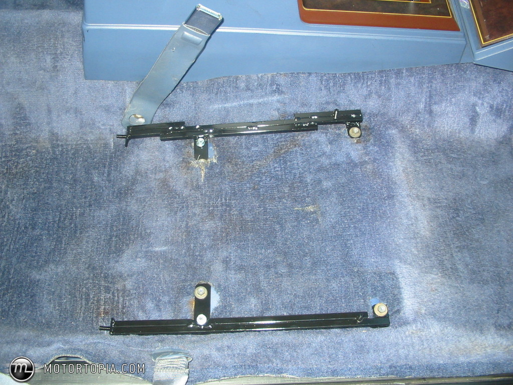

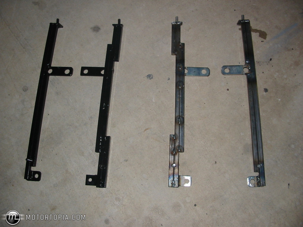

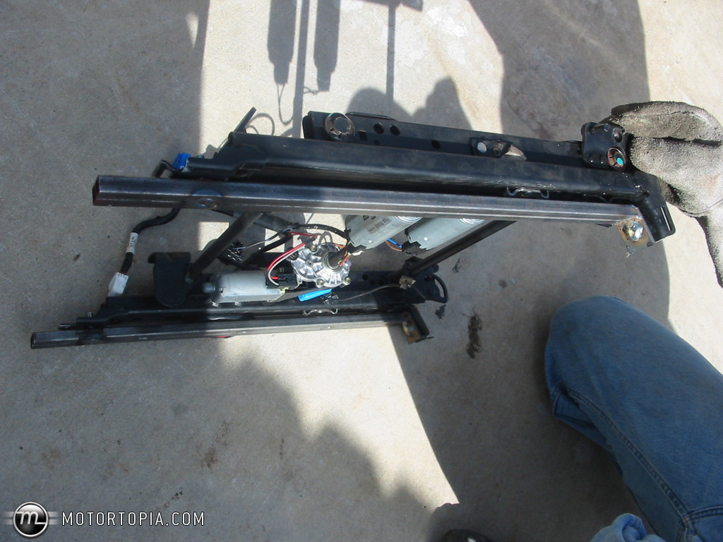

      Here is the solution we came up with for fitting the front seats in my car (thanks Thomas).
      I hope this gives you all some more ideas/options.
      The bar stock is 1/2" sqare, the rear tabs are 1/4" trimmed to match the seat's trimmed rear rail 'ears'.
      The rail studs are M8 1.5 metric bolts, similar to the cars mounting points, counter sunk and/or welded in. The holes are drilled out almost to 1/2" to allow some wiggle room to adjust before locking them in place.
      The seat rail adapters have 2 washers in the middle welded between the long tabs and the frame rails to get the correct height needed.
      I did 'massage' the floor on the outside ridges next to the seat belt anchors, to give the rails 1/4" some more space. It is a tight squeeze, not for everyone, there is a bit of adjusting to get them centered just right, but it's worth it, IMO.
      The rails are set back an extra 2" from the stock location, I am 6'3" and wanted a bit more legroom, and now I even have 1-2" extra travel I don't have to use. These seats travel forward an amazing amount I would never need.
      Mocking up the rails on the seat power tracks:
      Here are the front seat rails, pass side is painted, the notch helps clear the tranny tunnel brace:
      Painted, trimmed, installed in car after seatbelts are in:
