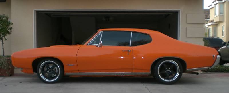

      Corona, CA
      193
      Here's a picture of my 67 Pontiac Tempest that DriverzInc help me set up with wheels/tires and suspension. I'm running a 19/20 combo.

      Wow, looks good.
      Thanks for the picture, that helps me to see how big the wheels look in the wells... something I was having a hard time envisioning.
      You wouldn't happen to have a straight side-profile shot of that car would you?
