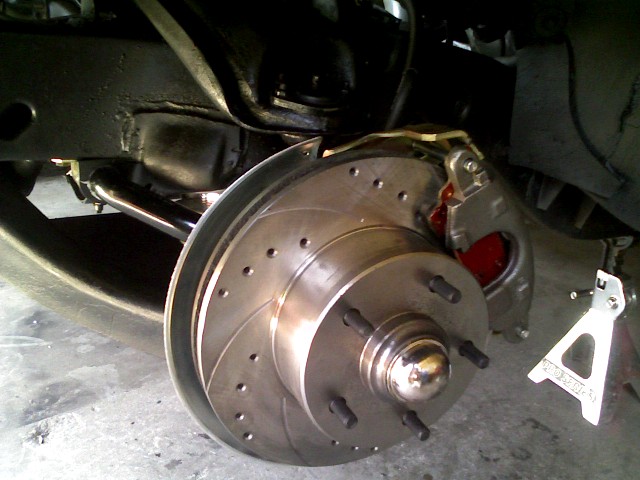

      Would I be able to run a manual master with my OEM style calipers?
      Fronts:
      Rears:
