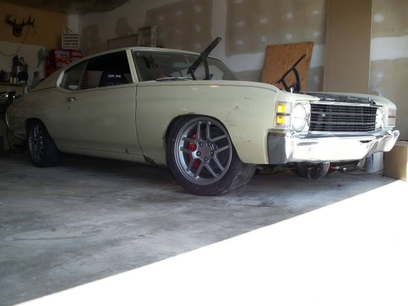

      Just finished installed Varishocks bolt in coilover kit. Came with their 650lb springs. Maxed out on the adjusters, I am slammed, bottomed out. Too low. It has just enough that if I lift the car by hand it will hold it, until you push on the fender again.
      Askin the pro's here or people that have an idea. I'm thinking of going with 1000lb springs... I can choose from 850-1300lb. Any thoughtss???
      Heres a pic of how it sits.
      thanks gang!!

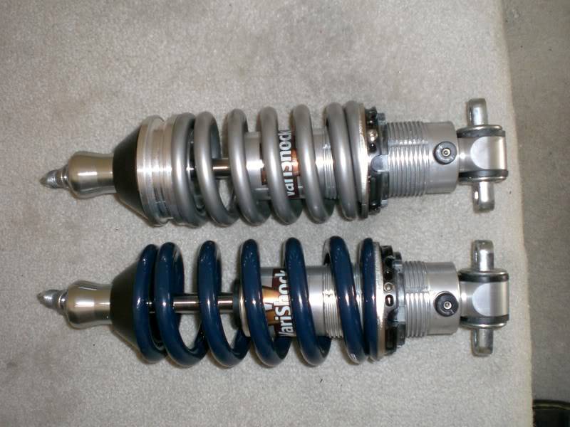

      Looks like you have the SPC lower arms. I was in the same situation 650s with a 1 inch spacer and still on the ground. I went and got Hyperco 8 inch 750lb springs from Speedway. No binding and plenty of adjustment. Make sure you set the shock in the middle of its spec travel.
      I needed a 1/4 inch spacer in the lower control arm under the lower coil over mount to set mine perfect.
      Note that this is with an all iron Pontiac. Think big block weight!

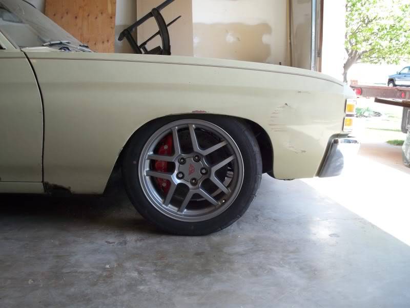

      Before:
      Here is how it sits now:
