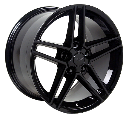

      Yeah, the F-Body wheels were one of those impulse buys My ultimate goal is to run a set of C6 Z06 wheels, but I don't want to have to run spacers to use them.
      I may go with a set of spacers until then though, my sub-$500 options are slim to none outside the spacers I think.
