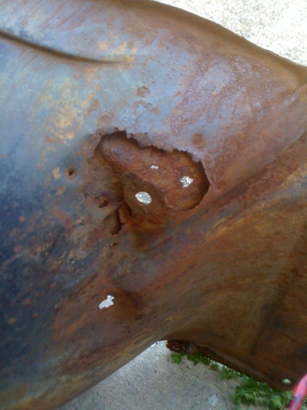

      Inner fender had some rust issues.
      They're fixed, although I need to do a little more cleanup.

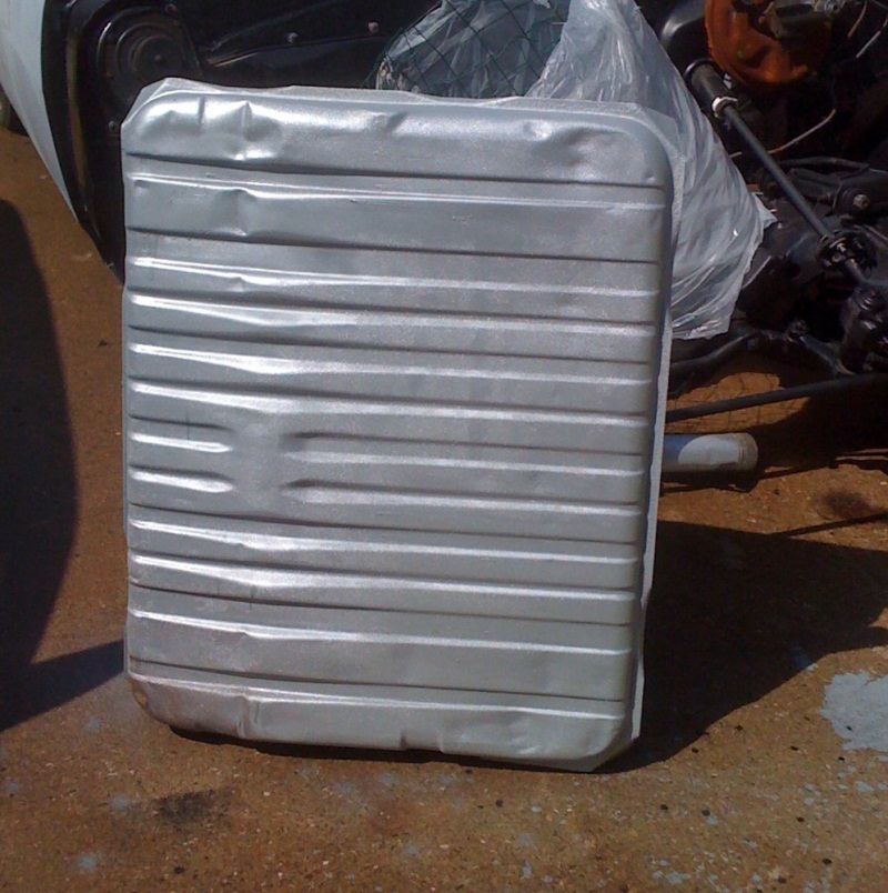

      Fuel tank cleaned out and sprayed with a "Cold Zinc Galvanizing" spray (yes, I hadn't got the very bottom when I took this pic):
      Tank should be fully dry today so I can get it installed over the weekend.
