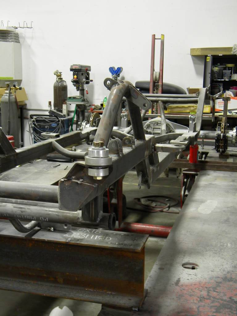

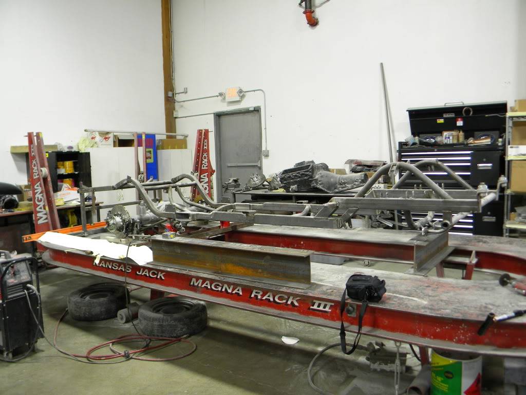

      Today we are making all final tweeks to the chassis, a few adjustments that we decided to make to hit the ride height we want to acheive, as well as putting in some additional gussets, a little extra insurance for the 850hp BBC we have planned. I did get word today that my Autorad autoradradiators.com aluminum core support and radiator should ship out on the 29th, right on schedule! Which is the last missing piece to finishing up the RS grill assembly. We are still planning on a early July paint date as long as I am able to get the dash and center console fabricated in time.
