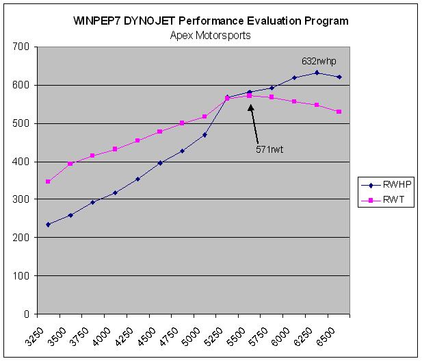

      My current heads are Edelbrock E-Tec 200's, ported, with a ported Holley MPFI single plane. Here's my last dyno run entered into Excel:
      Are you running an intercooler? And what CR and heads do you have?
      My blower is a Vortech V-2 T-trim. Running 1 3/4" headers into full dual 3" exhaust w/crossover. 75lb/hr. injectors, 9.6:1 CR, 1000cfm 4BBL throttle. My IC flows over 2000cfm.
      I also run a locked converter which is good for at least another 30rwhp and 25rwt. I know because my first dyno session I compared it back to back unlocked vs. locked.
      AFR's in the 11.6-11.8 range at WOT and high boost. I've spent a lot of time tuning this and datalogging runs - I'm on tune #96 right now.
      Oh, and the belt is tight as a drum!
