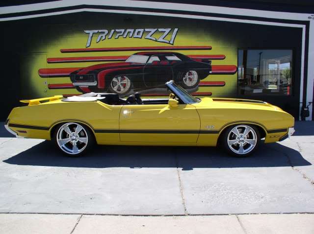

      here's a pic of a 20/18 for you. I believe the rears are either 275 or 295 on a 20x10

      Quote Originally Posted by 71OLDS View Post
      That is SHARP!
