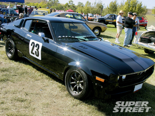

      its crazy.. i go to Japan 2 times a year and i meet up with these old datsun club guys out there.. some BAD ASS cars ive seen.. one of them is this shop car called Common Snapper and its a white 73 Z flared and bad to the bone.. just from messing around with those guys for so long i almost picked up a 78 Celica with the smiley bumpers.. but it looked so much like my 2 67 camaros so i decided not to..
      if i could i would build an old skyline..
      or a celica like this..

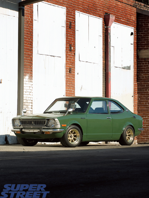

      i had one of these bad boys when i was active duty. It was a JDM import, even had wheels like this one. GOD i loved that car. My ex wife killed it. Rearended a pickup truck. =(
      1973 SR5 Corolla.

      My first new car was a 1973 Corolla w/1600cc Hemi....You guys are killing me with these cars.....
