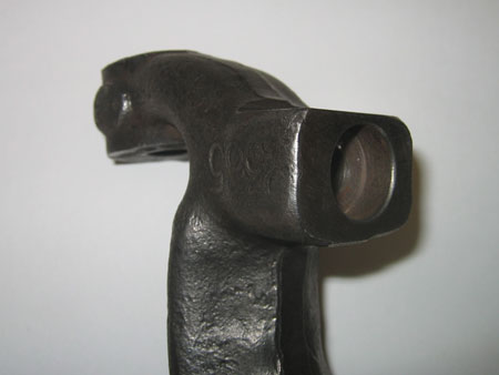

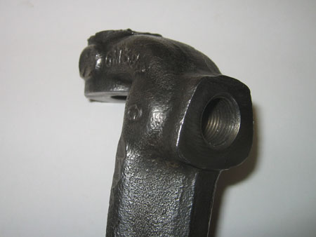

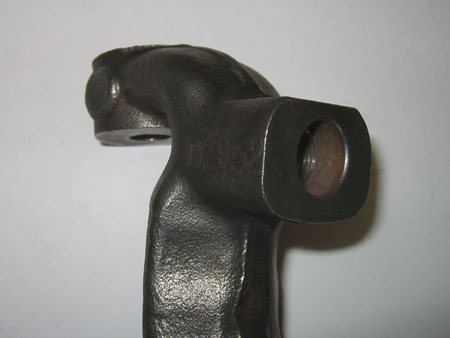

      And here are the pics they show for the short spindle:
      These all look like old front drum spindles to me, as well as the image below:
      Scot
