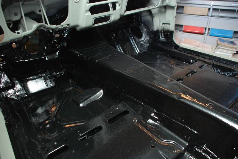

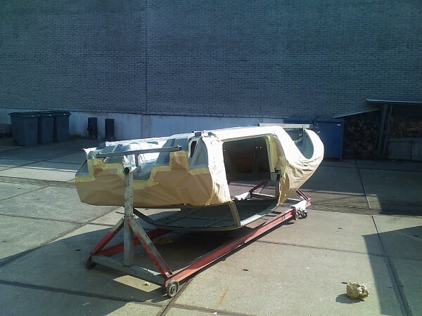

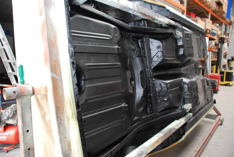

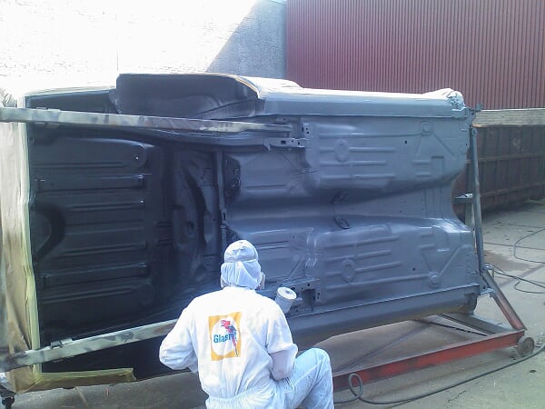

      body treatment
      Small update from across the pond.
      The body was set in epoxy primer a while ago. To finish the bottom inside and outside a stonechip protection has been used
      On top of that a primer and a black top coat of paint, turned out real great.
      The next step will be putting back the body on the subframe and rear next week!!!
      Cliff

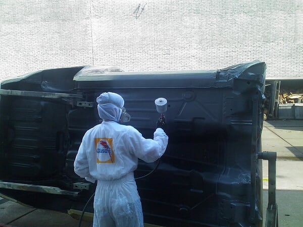

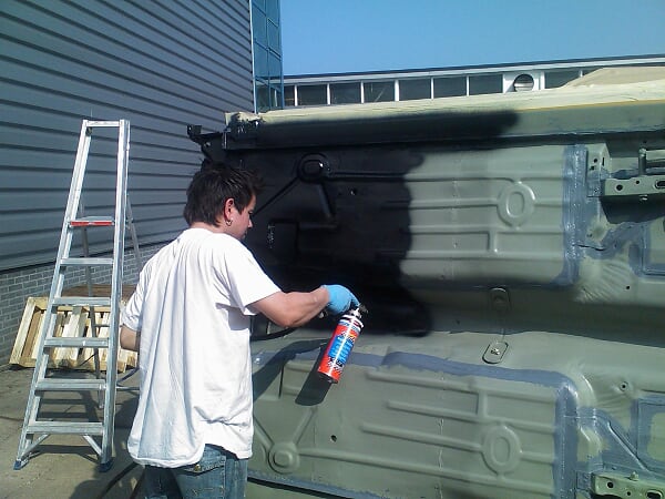

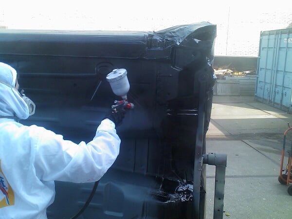

      Here are some step bij step pics, my homie Michel at work!!
      Erik

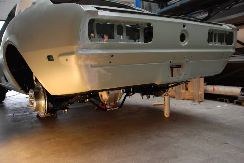

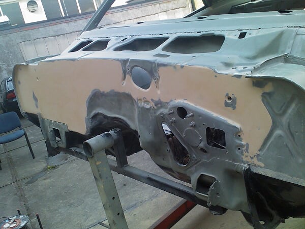

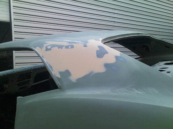

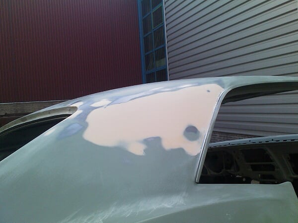

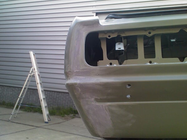

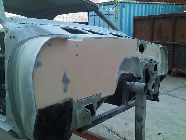

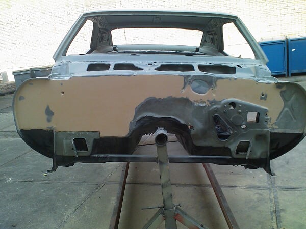

      Started with some bodywork:
      Erik

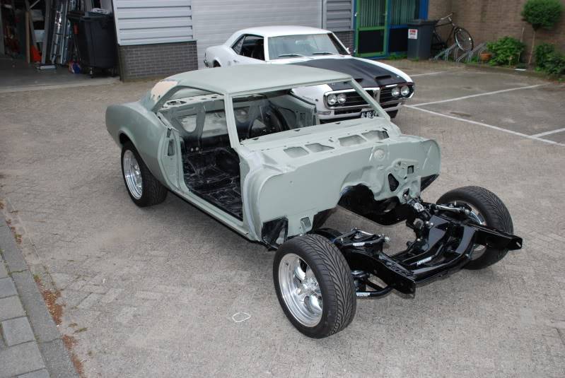

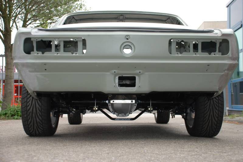

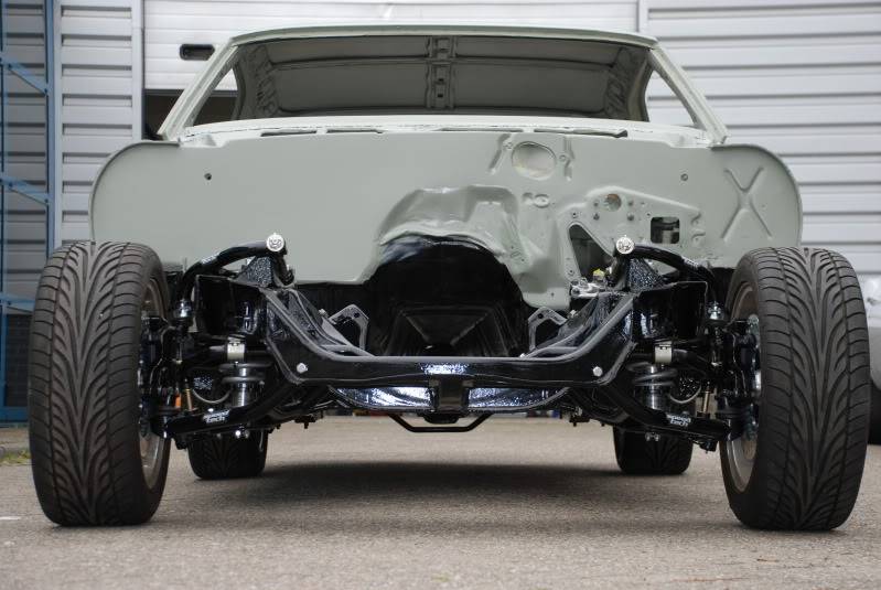

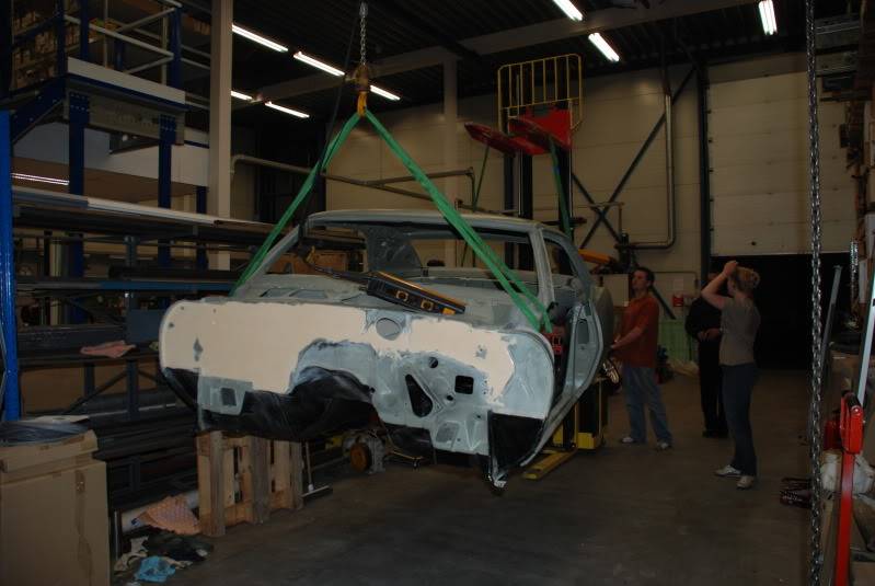

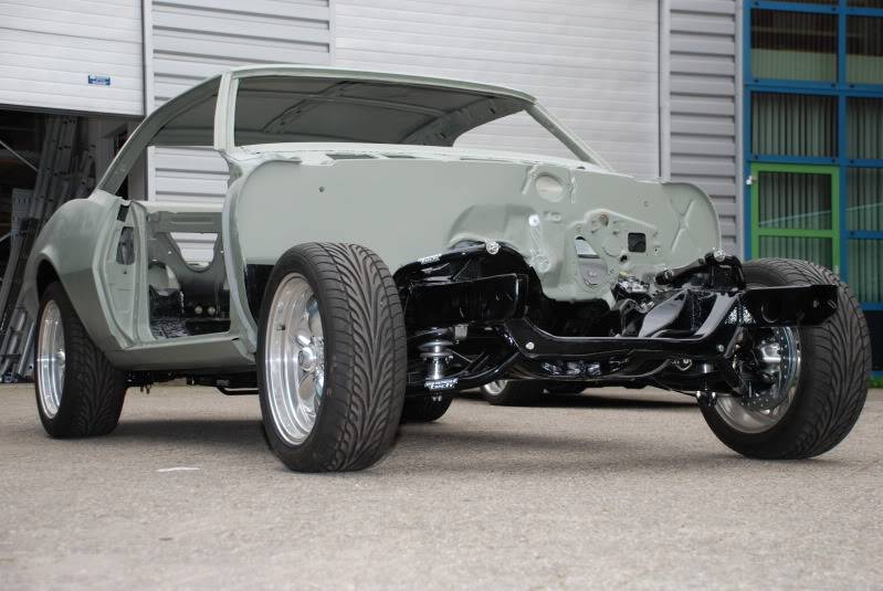

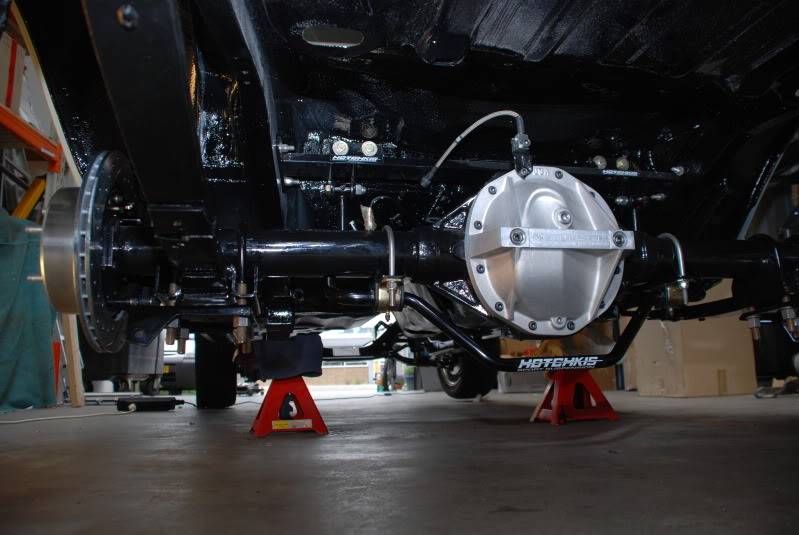

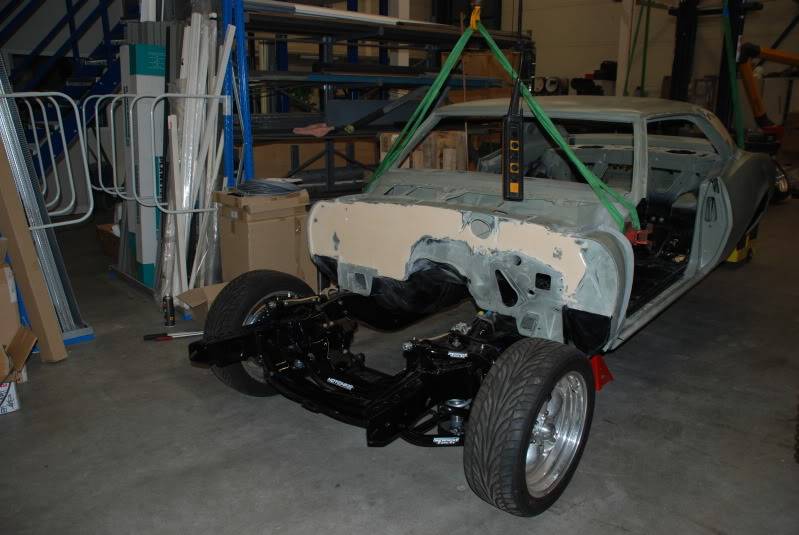

      After a major delay from a Dutch parts supplier for some 3" drop DSE leafs we got an update. We made a big step on Erik' Camaro (almost witnessed a big man cry ). It's a ROLLER!!!
      The body has been put on the fully prepped subframe, 12 bolt Moser, leafs, rear sway bar and subframe connectors welded and bolted in. TTII for mock up only.
      The firewall was treated a coat of epoxy primer.
      Some pics:
      Cliff
      1968 Firebird
