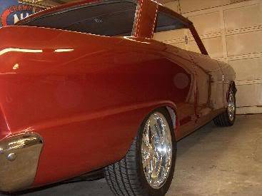

      Thanks to my local tire and wheel shop, 1010tires.com, I was able to "borrow" the wheels I am putting on my car for a test fitment. So far they fit almost perfect, not bad for outta the box! These are the ones I picked: ADR M-Sport 18x8.5's for the rear I might be able to fit the 18x9.5's they have too.

      That will look sweet! I considered the M-Sports when I was looking, though the offsets weren't quite right for my application.

      Those wheels look great! We have had alot of different wheels on our nova also and just by looking at your pic these will probably rub the inner fender well when the car is set down. But if you are going with a tube chasis you will most likely remove those. That is where we had all of our problems. Just our thoughts.

      Thanks for the heads up, its tough trying to do something that the tire shop has never done...and most cant quite comprehend..."you wanna put those wheels on a what?" So any one with experience with aftermarket wheels and a chevy II is a HUGE help.
      Those wheels are a +32 offset, and the come in a +48. I think the +48 will fit with that inner lip removed or flattened.

      They look really nice on there. I bet you cant wait to get your set and slap some rubber on there. I noticed they are different than the wheels in your avatar?

      You are correct..they are different than the avatar. The ones in the avatar werent available in the offset I need.
