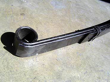

      You will however... need an idea of what you want. It will look something like this on the front half of the spring:
      Viola !! Instant traction bar... in stealth effect.
      As far as spring rate... I believe all that I would do if I were you, is just have the second leaf made like the above picture. Specifically, the only difference will be in the front half of the spring... and the rear will remain the same length as it is on the exisiting leaf pack. The second leaf should be constructed in the same material thickness as it currently is. That will increase the rate effectively, very little... to keep your ride quality the same.
      ** Mind you that this specific design will only work with standard front spring eyes. With a center or reverse eye... it will be somewhat different. Obviously...
