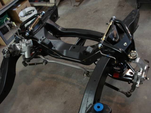

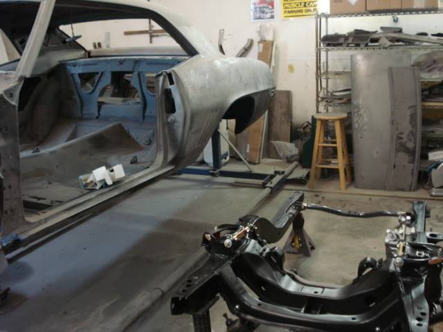

      Yeah I know, another '69 Camaro. Same old story… Since I was a kid, I wanted a '69 Camaro. Nine years ago, I acquired one out of Las Vegas. Just a straight six car with one repaint. I tore it down had it plastic media blasted and went from there. The shell is in very good shape. After a wedding, kid, and second house. I finally have enough disposable income to get this project moving. Home build with the help of my buddy for body work expertise.

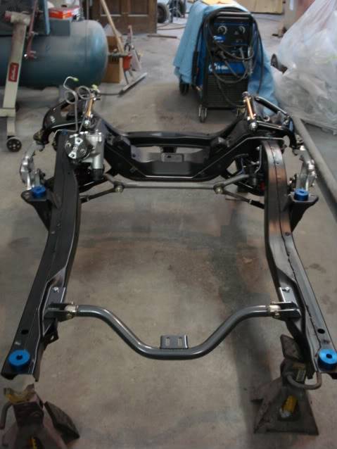

      Stock subframe

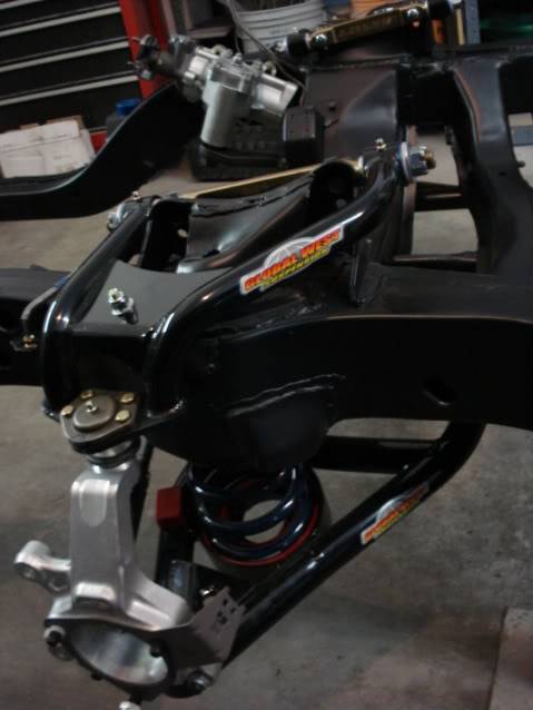

      Global West upper & lower CA's
      ATS LM spring adjuster/shock package 550lbs. springs
      AFX spindles
      ATS 670 steering box
      ATS T56 kit
      ATS LSX engine plates
      Hotchkis front sway bar
      GW solid body bushings
      GW subframe connectors
      GW L2 leaf springs
      Still contemplating on installing 4 point roll cage. No engine yet, probably end up with an LS3. Currie 9" for the rear. Rolling chassis should be in the body shop within a couple of weeks. Sticking with the original color of Azure Turquoise with SS hockey stick stripes.
