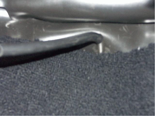

      Don't know about other people, but on mine I took a piece of 1/2" stainless tubing that I had left over from my fuel lines and bent it a little less than 90*. I drilled a hole in the top of the toe board on the passanger side and ran the tube through it. I used the plastic piece that came with the kit and connected it to the tube. I put some sealant on the connection to keep it from leaking inside the car.
      A couple of pictures to help you see what I did. This one is a little blurry because the camera wouldn't focus very well in the dark...

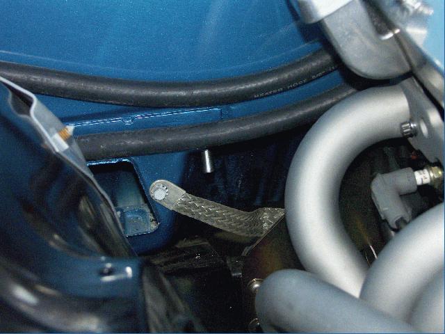

      You can see the tube a little from the engine compartment. It's in the center of this picture.
