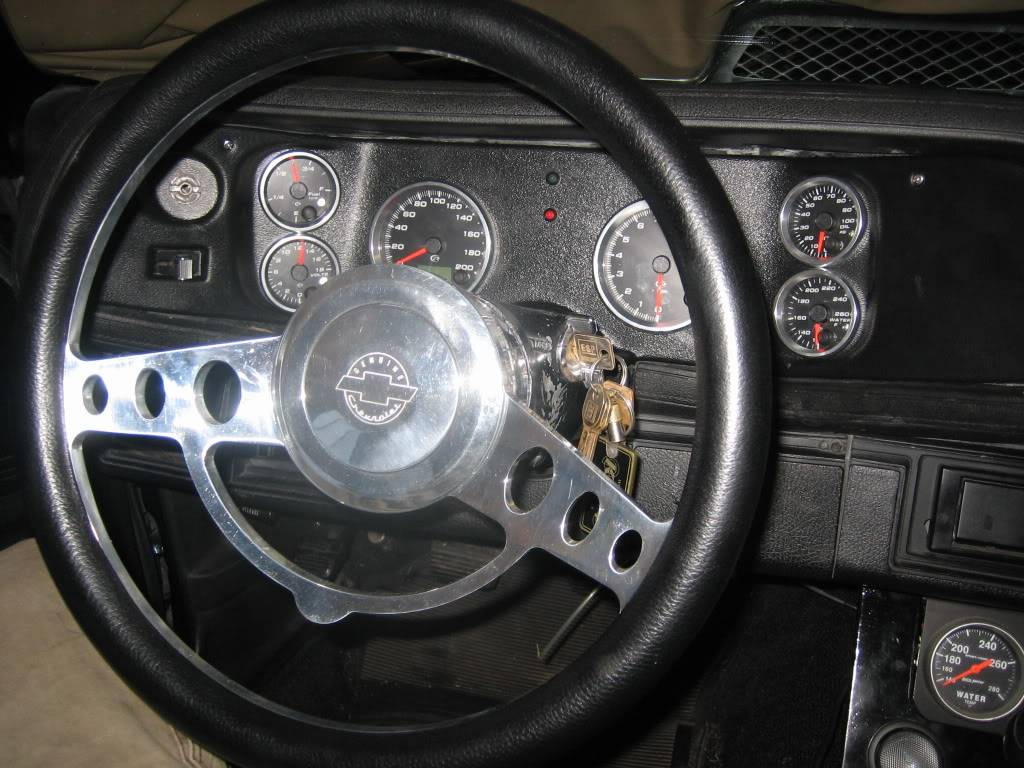

      I just used aluminum with autometer gauges.

      That's how I want mine to look. I really like that Chad. Did you build this yourself? I would like to see your console, I see a dvd unit in the corner of the pic. Any pics of the whole car? I really like seeing other guy's cars, it gives me ideas on what to put together for my car. I'm not trying to copy other cars just put my spin on great ideas. Thanks for all the help guys I really appreciate it. This site is really helpful. I'm glad I found it.
      west michigan
      514
      I did it myself. It was pretty easy. I just made a template out of poster board transfered it to aluminum and cut the holes and bent it. The gauges are autometer and for wiring I just used the painless wiring gauge kit. It was really easy. Good eye on the dvd screen. I used to have it with an alpine deck in the pic but I recently put in a jvc dvd player in. There are more pics here if you want to check them out.
