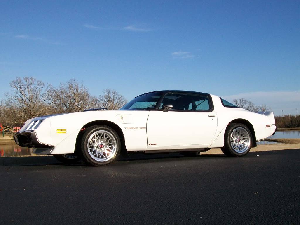

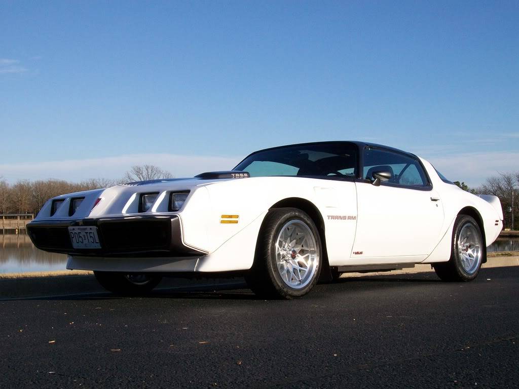

      Here's some quick pics of the Year One snowflakes. The car is dirty, but I am ecstatic with how the wheels look. As good is it looked with the Rondell's, these look awesome. The silver is lighter than I imagined but looks real good. The center register of the axle did not protrude enough to catch the wheel, but no vibration up to 50 mph. I will be contacting Moser to see if they can make a ring for me to fit inside their axle, just to be safe.
      BTW, the Rondell 17 x 8.5 that was on the car weighed 27.5 pounds, the YO snowflake 27 and a factory 15 x 7 snowflake weighed 21.

      That looks great

      car looks great! those the cast 17X9 YO snowflakes, right?

      Those are awesome.

      What size tires?

      Looks good. They did a nice job on replicating the originals. IMHO you should put a tire on that has a taller sidewall.. and drop the car about 2 inches. Just my .02

      They look very nice!!!

      I would like to find a tire with a taller sidewall and right now it looks like Nitto 555's in 255/50/17 will be at the top of the list when I get new tires.
      As for dropping it, it might look a little better but I drive my car a lot and right now, the front suspension is pretty close to centered in its travel at ride height. The frame rails are level so things are pretty much where I want them.
      By the time we add a tool kit, luggage for two, and two bodies, for trips the rear drops a little bit.
      As with everything, there is a compromise. I set mine up for max suspension travel in both directions for the best ride. If I lower the front, I just don't have much left for bumps. For me, I wasn't willing to sacrifce ride quality for looks.
      I would love to see a 275 or 285/45/17 as that will get me a taller sidewall, much closer to the factory overall tire/wheel height, and still fill out the 9 inch rims real well.

      I agree YO did a wonderfull job on these. I cleaned the car and I am stoked about the wheels. While I was at the park taking better pics, a couple people had to walk over to look at the car.
      Here's some better pics:

      They are factory lugs for snowflakes, but they are different than the factory lugs used on the Rally II's.
      I see no reason why 285/40's won't work and when I need new tires, that will be what I am going with.
      I haven't seen anything that is close clearance wise.
      The only problem I am having is that the hub on my axle is not tall enough to catch the center bore of the wheel. It's not really a problem of the wheel or the axle, but a combination of the two aftermarket parts not working well together. Moser has been great getting me meaurements so I can find or have made a hubcentric ring that will press into the ending of the axle to correct the problem.
      I have a vibration at 70 that was not present before the swap to the new wheels.

      I think they'd look great on a Fiero, but I just don't know if a 9 inch rim would fit.
      BTW I went back to my ws6 springs which dropped the rear about 1/2 per side. I then dropped the front to match and have to say things look much better.
