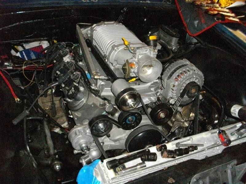

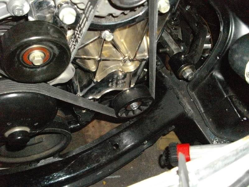

      I put a pulley through one of the Powersteering bolt holes with a spacer a friend made. Seems to work well. The belt appears to be tight enough.
      Next step is the gas tank, fuel lines and the hyrdrolic clutch kit from ATS.
      I will post pics tomorrow.
      Thanks guys,
      D
