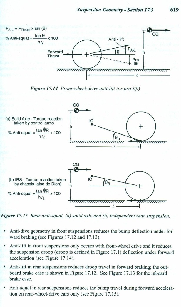

      It's a lot easier to understand if you have a picture to look at. Hope this works and that it doesn't overload Jon A's bandwidth, as I'm out of upload space here. It's originally from RCVD and the "Slider construction line" is what I called the perpendicular line. The roll axis line is not the TA line through the axle center or the chassis pivot.
      The IC vertical and length dimensions go in the linked calculator.
      Antisquat stuff (the middle picture is for solid axles)
