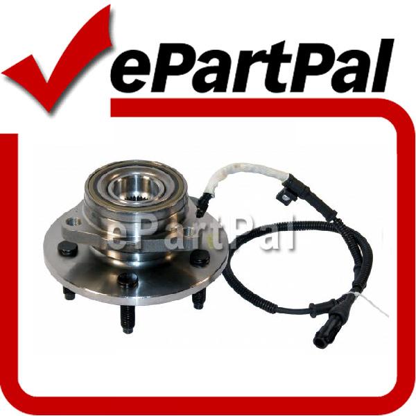

      F-150 2000-2004:
      Enough material to make a new bolt pattern, and tight packaging.
      Is this a complete bearing, or do I need the drive shaft to prevent the wheel hub from falling apart? Or is the part on the picture "one piece"?
      Otherwise it looks good, it should be enough for a 2300 lbs car on slicks.

      I'm glad that helped. To tell you the truth, I'm not much of a ford guy, so I can't say with 100% certainty whether you need the axle. Maybe someone else can chime in.
      If the ford is anything like Chevrolets and Jeeps, you can run the bearing without an axle. The bearing takes the load. The axle is only there to provide power.

      It you want to run 4WD you will need the axle (note splines.) but it will work in this configuration. Otherwise, you may want to consider a 2WD version to reduce costs.
