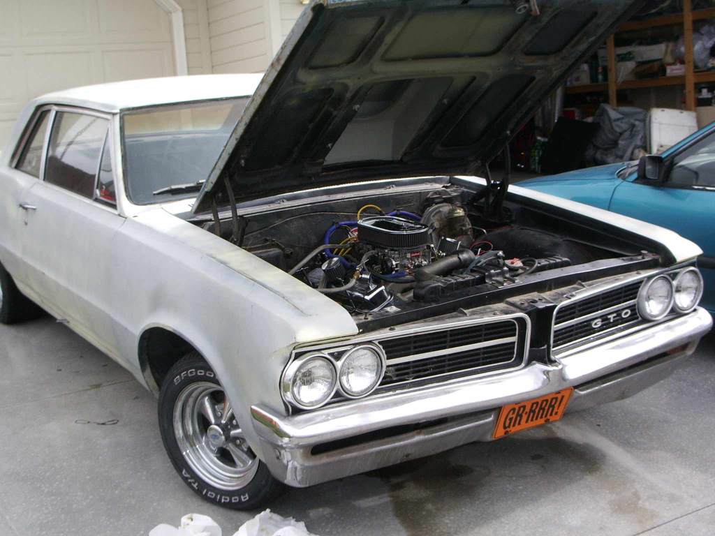

      Here is the car a couple weeks after i got it (the mailbox hoodscoop will NOT be on it for very much longer, i have a spare steel flat hood)

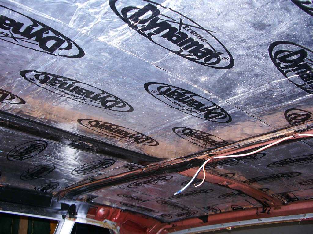

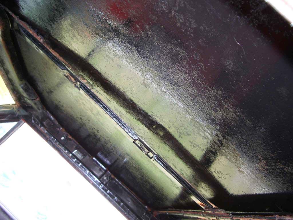

      here is my roof after a good wire brushing and a couple coats of por-15
      after the por-15, on went the dynamat

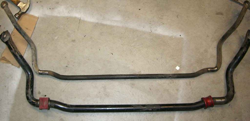

      My new swaybar is way bigger than the puny stock one!

      i forgot to talk about my sway bars, i have both front and back, i just eyeballed them with a tape measure, they look to be 1 3/8" up front and 1 5/16" in the rear, though i could be off a 1/16" or so, they were my dads old sway bars and he doesnt know what brand they are, but he thinks they may be old HO racing swaybars. (they are also both solid).

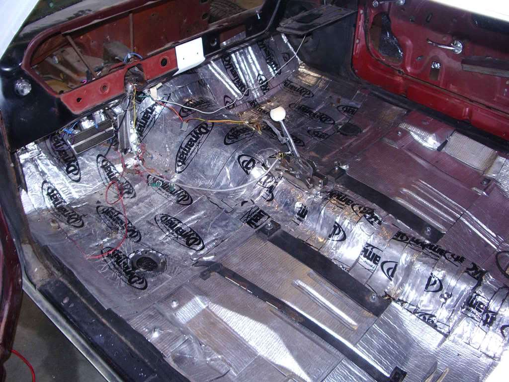

      I finally got some pictures of my progress over christmas break!

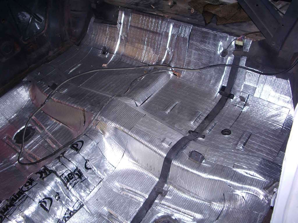

      sound deadener over the whole floor

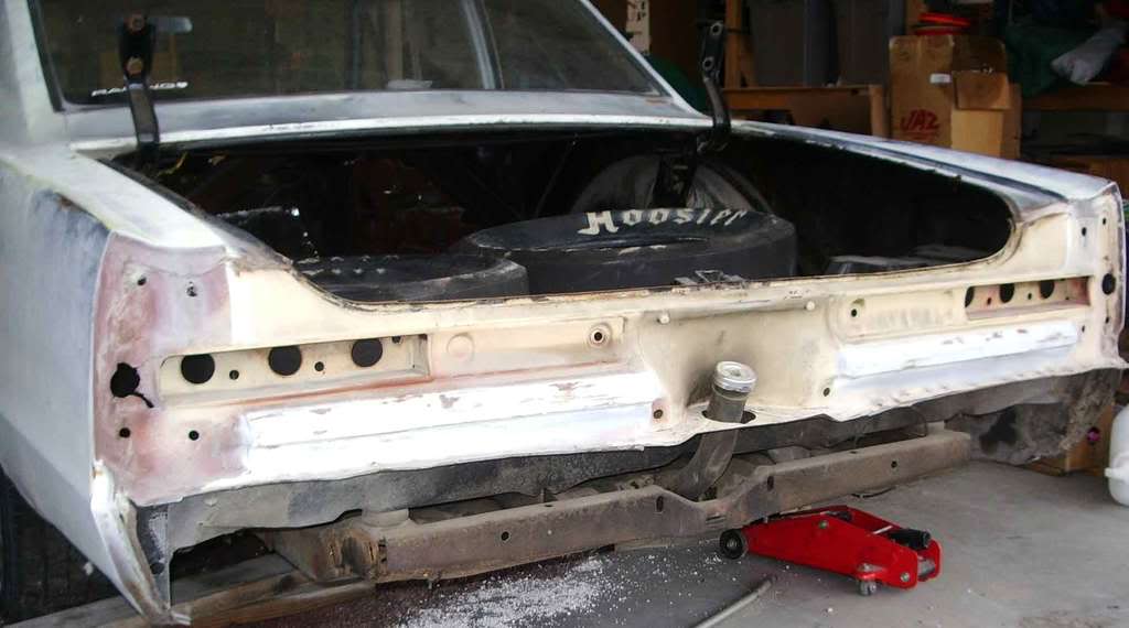

      took off the rear body stuff

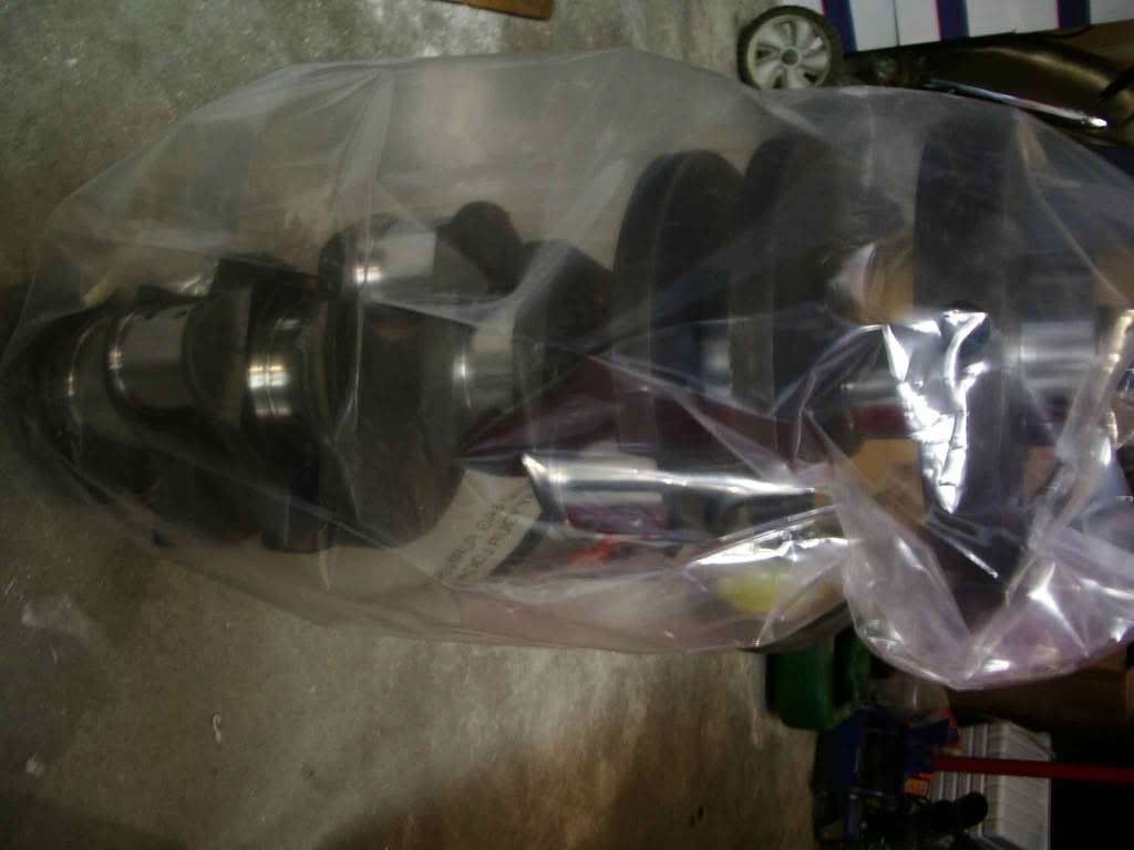

      and got my block and crank back from the machine shop (block was honed, and crank was ground)

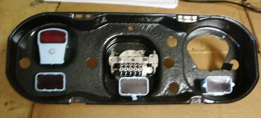

      started on refurbishing my gauges
      Also redid the dash (needs to be cleaned though, there is a lot of dust still on it, i am also debating whether to paint the heater control satin black or not)
