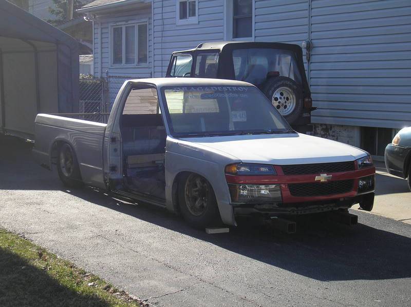

      heres some truck pics
      photobucket
      http://s109.photobucket.com/albums/n...daily/?start=0

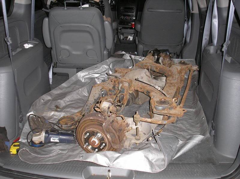

      i havn't started the irs yet iam making rear spindles first. then a frame table then the frame and irs. here a pic of the irs for the mark viii. the day i got it 50$. 8.8ford. i have a ton of pics in my photobucket my truck,bike, my dads 69z28 302 zapper, brothers 89 351 saleen. link is up a couple of posts.

      I saw those after I entered the other post, I couldn't figure out what it came from.
