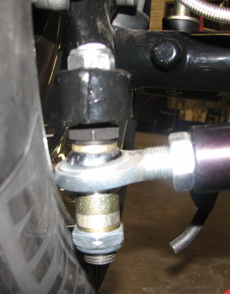

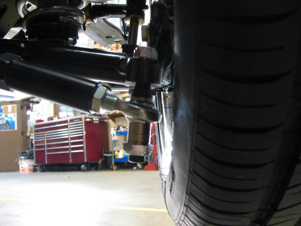

      Brian, this is completely solvable, without going to too much effort. I had a similar problem with my Rushforth wheels. We went with an aggressive front backspacing so I could lower my car more. What I ended up doing to fix it was to shim the steering arms away from the wheel/sidewall. You might need to get new longer bolts for the steering arms, make sure you get grade 8 or better hardware.
      From this:

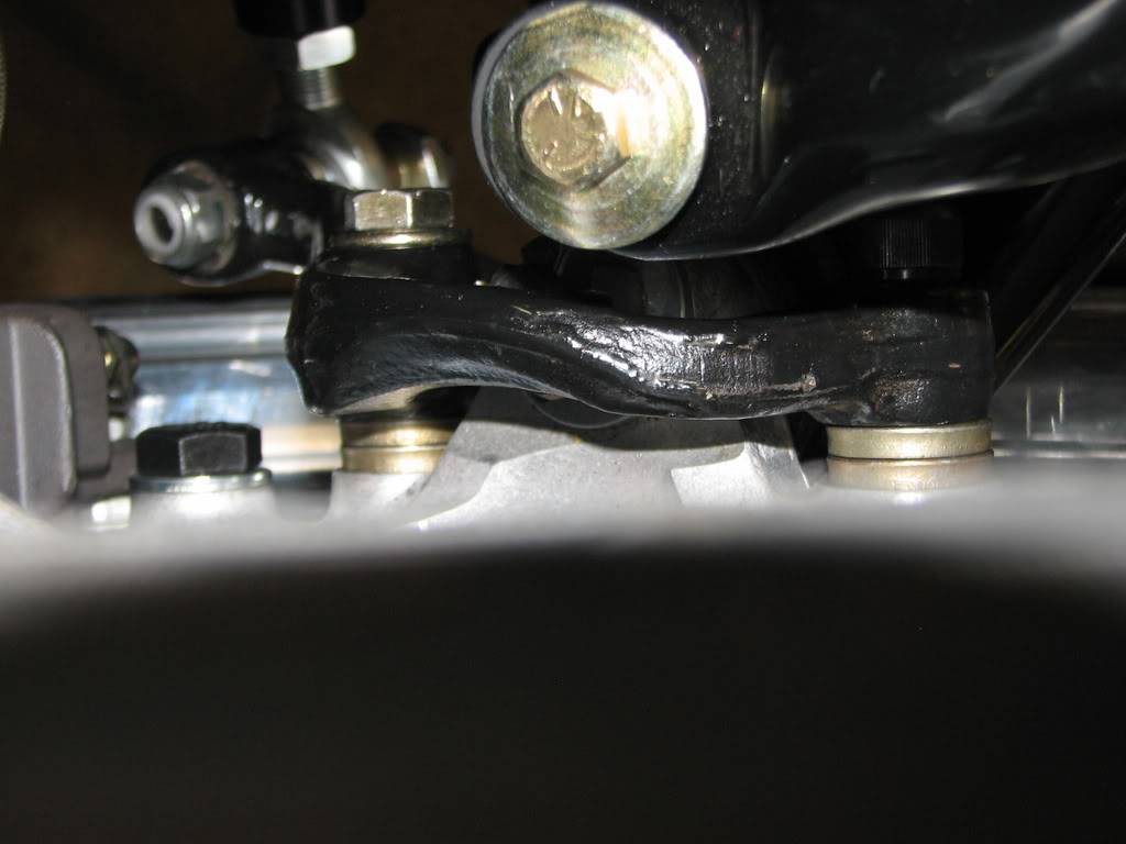

      Shimming with a couple hardened washers:
      To this:
      There is no shear load on these bolts so shimming them with washers is completely safe. But I would definitely talk to Jon he completely stood behind the product he sells. He was great to work with when I bought my wheels/tires.
