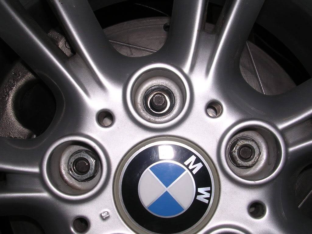

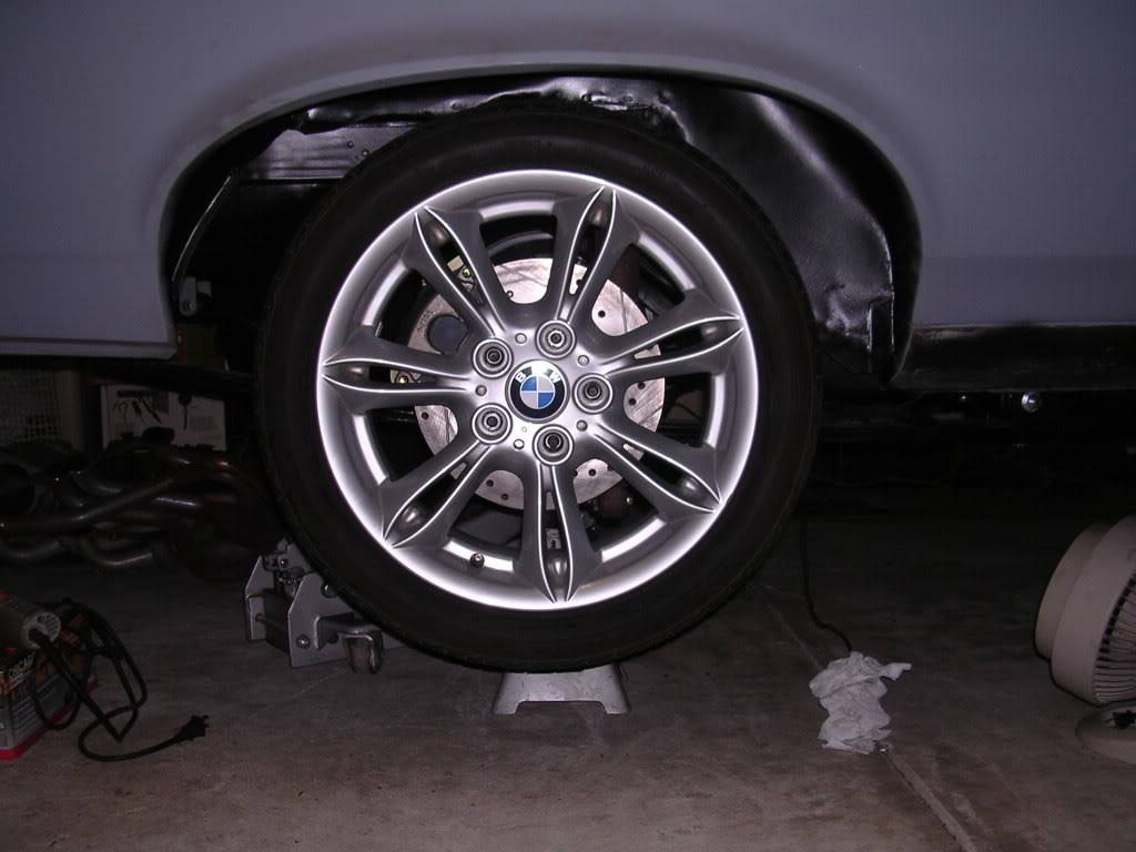

      Here is a pick of 17*8 6.29 inches of backspace from a Z3 I needed 1.25 inch spacers on the front and 1 inch on the back. Some 5 and 7 series wheels may not need spacers. All 3 and Z series will. There is a site on ebay that sells the 1.25 inch BMW hub centric spacers that work better than the Chevy spacers.
      I don't have the rear spacers on in these pics so it looks funny.
      Pics without any spacer to show stud centering

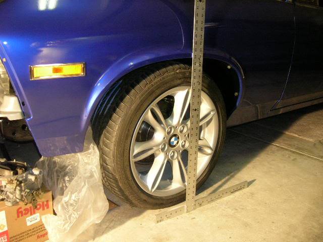

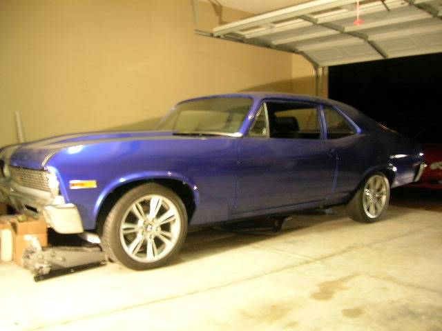

      Personally, I don't think the lug pattern is a problem at all if you get a hub centric centering ring. That way the lugs aren't supporting the car, they are just holding the wheel on.
      Here's a pic I took of my car with some 18" M3 wheels on it. I had them on there when I aligned my car so I could use our special wheel adapters. Actually didn't look too bad but would have needed spacers on the rear to look right.

      That looks really nice. Do you know if these will fit over c5 brakes? Are you using any spacers? is that a lip out back i see? and what year are these off of?
      thanks
      Jesse
      Jesse,
      here's the link to the original thread from last year when I took these pics. Should have all the info you need. Oh, and in the pics I only have the M3 wheels on the front. https://www.pro-touring.com/forum/sh...ght=bmw+wheels
