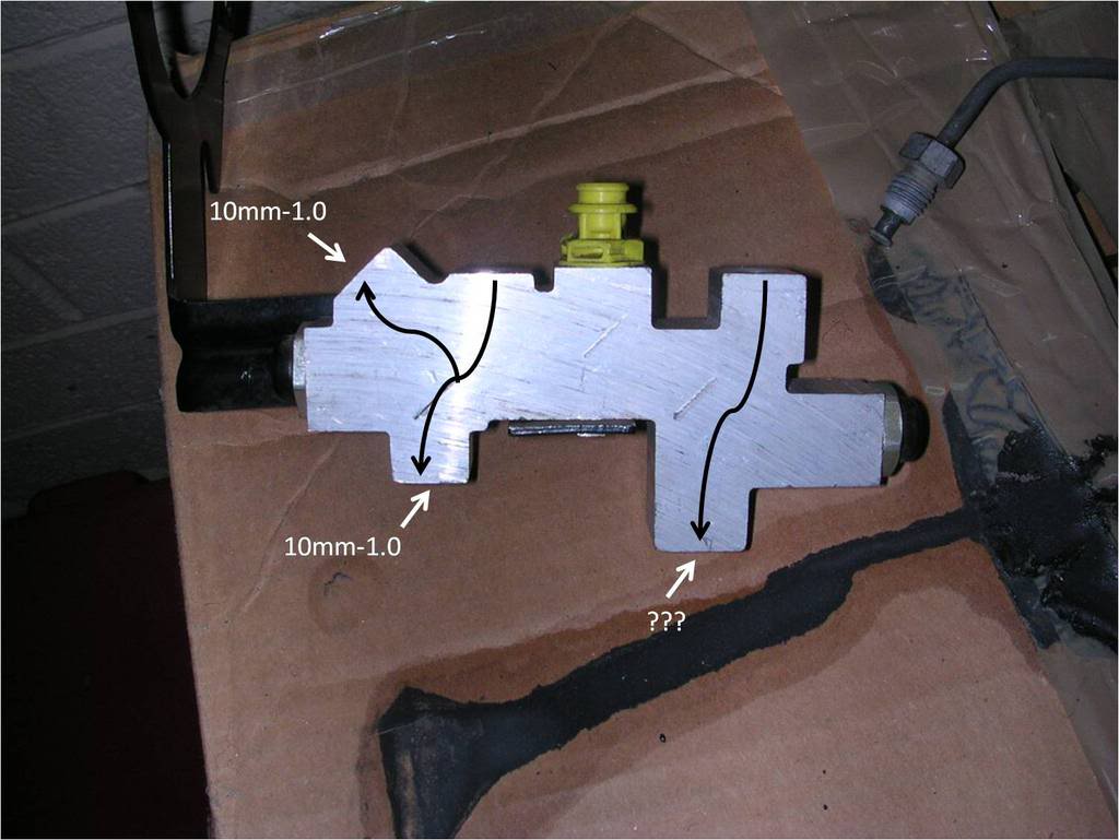

      This thing has me scratching my head; I am pretty sure that when I pulled it that the two rear ports were for the front brakes (which makes sense). However, my willwood MC reservoir is forward for the front brakes, same is true when I looked at a 4th gen MC. Am I off on this? Just what to make sure before pluming it.
      Also, anyone know the fitting size of the mystery port? For those that have used these Camaro prop valves, where did you get the adapter fittings? I have the line from the prop to the MC, although I need to find one adapter for the MC side, but did not take the bottom fittings. Thanks and Merry Christmas

      I think that might be a 11mm-1.5
