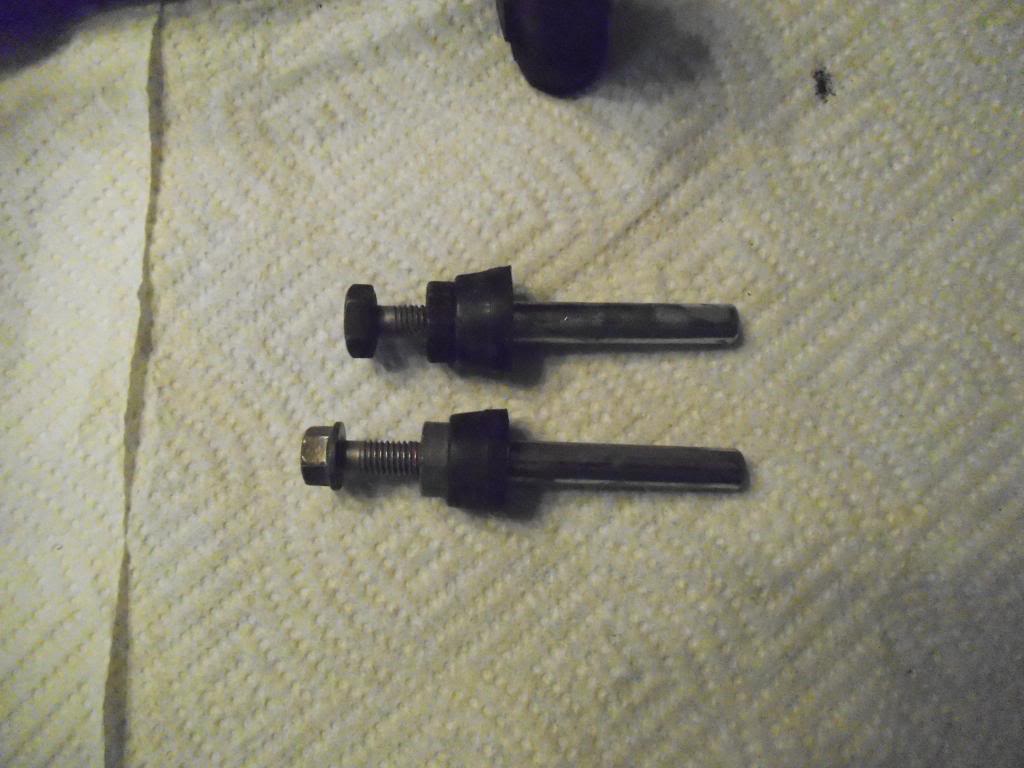

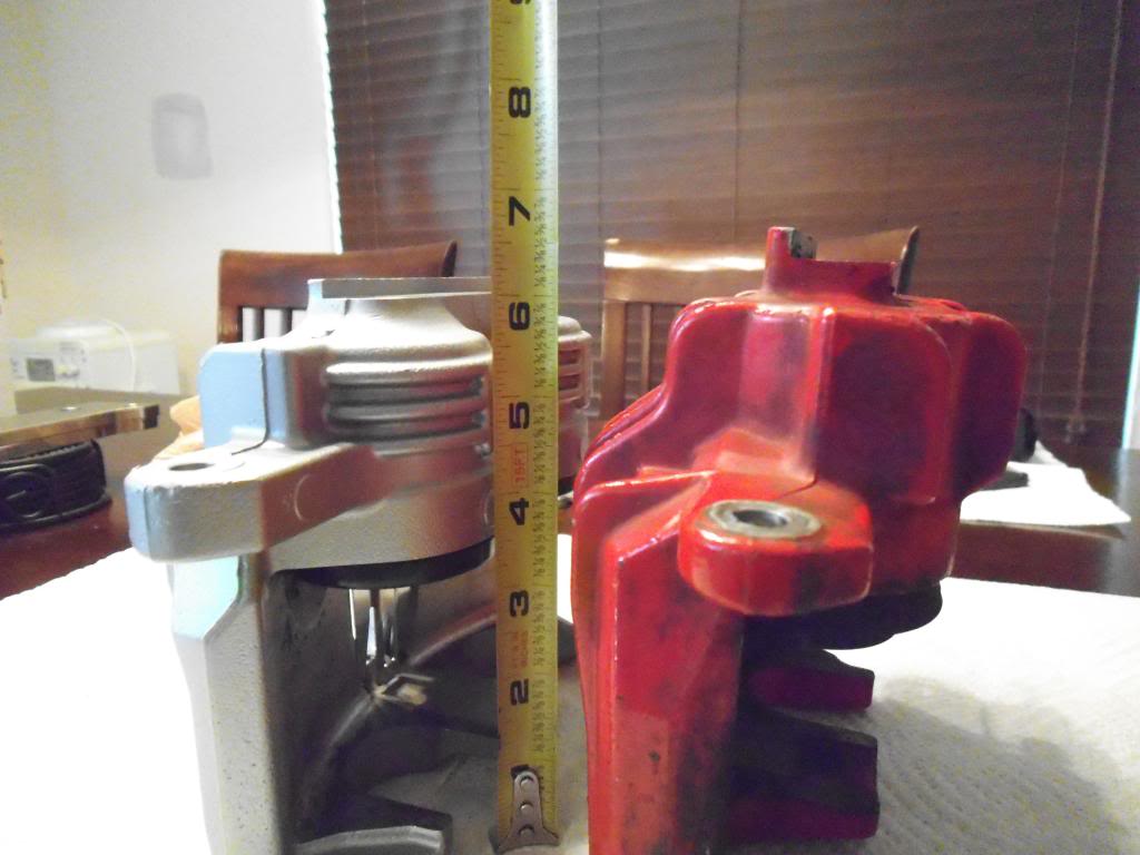

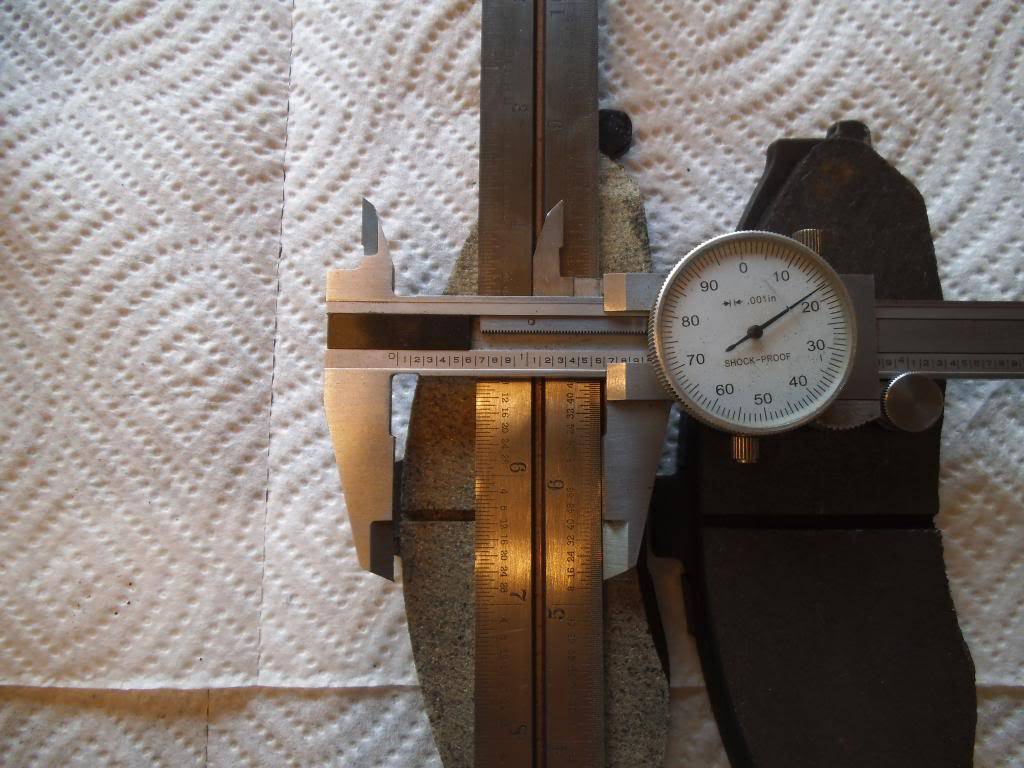

      i have been doing c5 and ls1 swaps for s10s, ill share what i can remember
      -piston size: C5 is 40mm, LS1 is 45mm
      -the C5 caliper casting is bigger, heavier, and much stiffer, with longer cooling ribs
      -the bleeders on the ls1 are parallel with the piston bores, the c5 is at a slight (10 degreeish) angle
      -the C5 caliper is taller and has a different radius for the 12.79" rotor vs the LS1s 11.92" rotor.
      -the LS1 caliper can be used on a 12.79" rotor, but no bigger (IMO, because the pad starts to overhang the rotor)
      -the C5 caliper is slightly wider, about 6.625" vs the LS1 at 6.2". may lead to clearance issues
      -the pad opening on the C5 is 2.625", LS1 is 2.5"
      -the LS1 mouting ears are thicker
      -the slider pins and boots are identical, the slider pin bolts are longer for the LS1 for the thicker mounting ear, but same thread
      -the mounting ears are the same distance, which makes the pin bores in the abutment the same distance between the C5 and LS1
      -the wear clips and the anti-rattle clip are all identical
      -the abutment offset (distance between mounting holes and slider bores) is taller on the C5
      -the abutment mounting hole spacing is the same at 5.040"
      -the rotor slot in the abutment is the same at 1.425"
      -the pad friction material is almost identical shape and size, just different radii for the different rotors. the backing plates are the same width and height, the ears are the same with the below exception
      -the pad ear offset is different, the C5 are lower pushing the pad outward, away from the spindle
      theres more i cant think of right now im sure
      C5 abutment on the left
      LS1 pad on top
      C5 pin on top
      LS1 pad on top
      pad ear offsets
      C5
      LS1
      anti wear clips on rigth, used dirty C5 on top, new LS1 bottom
      they are the same height and all the mouting bosses are in the same plane. the differences all lie in the "radial axis". C5 on the left
      the LS1 rotors have about twice the vane count, but are straight (unidirectional). because the C5 caliper have about half the vanes, but are larger in diameter, they are almost the exact same weight, as measured by my calibrated arms. and yes, the C5 rotors are directional because of the directional vanes.
