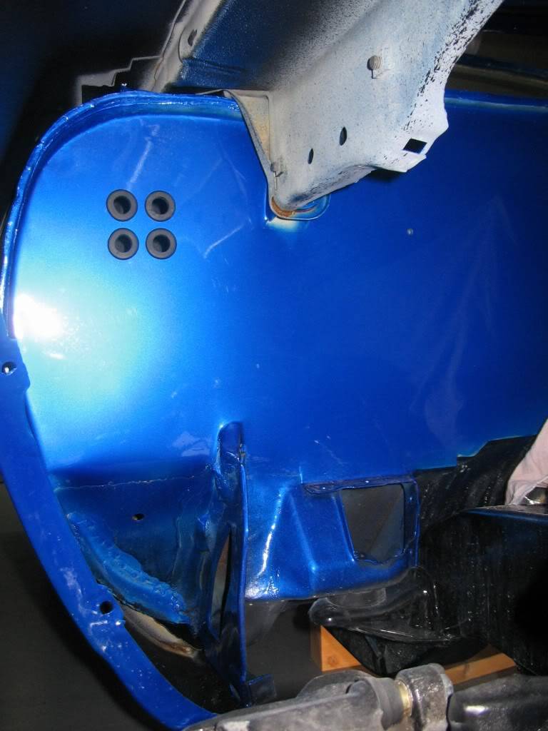

      Frank- What size A/C hoses did you run for Empty Nest? I decided not to use the bulkhead fitting on the VA system and drilled out the holes to 1" and installed grommets, problem is that the I.D. is only 11/16" and all of the hoses with the system seem to be closer to 1". Even a 5/8" heater hose would not fit through that hole. I was thinking of having some hardlines made to pass through the holes, but thought I would ask you first. Maybe all I need is a different type of grommet? Thanks.

      VA has grommets that has chineese finger type material in the center that kind of one size fits all. I can get them for.
