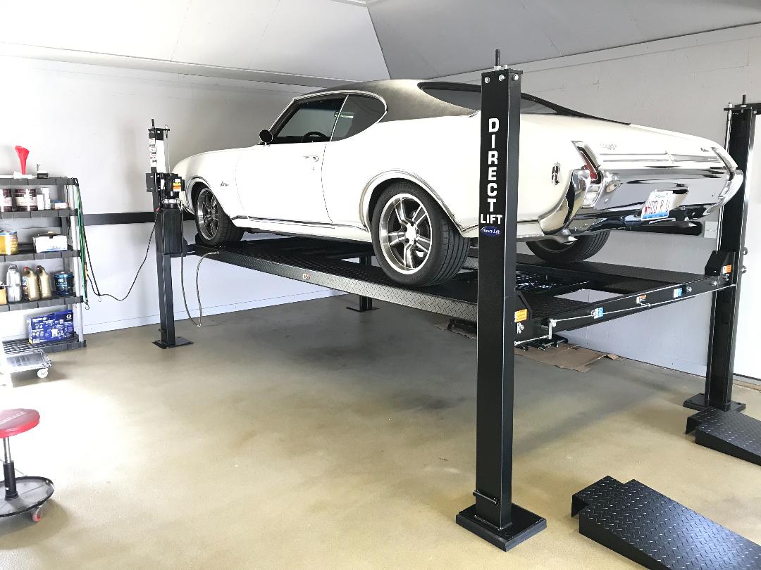

      I had a 4 post Direct lift installed in my home garage recently. I went with an authorized seller & installer. I was considering installing it myself, but after watching 2 experienced guys do it, I'm glad I paid for installation.
      Mine is a 110v version, and my only complaint is it's a little slow, about 2 minutes for full lift height. For me, this is primarily for parking and projects on the Cutlass, and oil changes and general maintenance on the daily drivers. Good news is, if I ever run 220v to the garage I can simply swap out the motor & pump and lift time is cut in about half. My garage is a double deep 2 car layout, so I had the ceiling in the back half raised and I insulated and finished it myself.
      It's very stable, I was concerned about that since it's an "inexpensive" unit, but I don't see any quality issues with it. I plan on adding a rolling jack bridge and LED uplights as well.
      Any questions I'd be glad to help if I can.

      nice lift. Did you put the rear spoiler on your 300? If so, what brand is it?

      Thank you. It's a factory spoiler for the 300S model.
