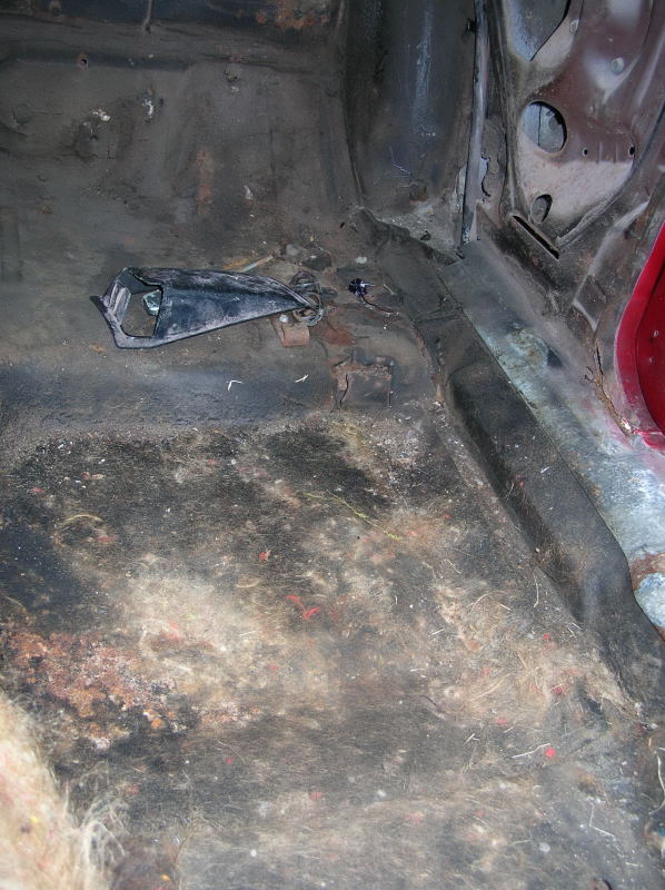

      well the passenger side is gone there is 10 inches by 10 inches gone and the rear(both side as been fixed but just with straight plates and rivets)
      and the driver side is allright

      here are the pictures off the project
      OK
      767
      Milow 68 has the right idea. Your pans don't look that bad. I would cut the rusted areas out. I use a air cutting wheel for this. Then take a grinder and grind the areas you will tack-for the welding. When you get your replacement pieces take the cutting wheel and cut then to fit your specific area. I would not cut anymore than I would have to.
      Make sure after you tack the welds in place to go back and completely weld the seams shut. Feel free to ask any questions.
      Is that fiberglass filler on those floor pans?!
      10
      Andrew[/QUOTE]
      no it is just straight sheet metal plates they put rivets,to put it on,
      so I guess I would change those too
