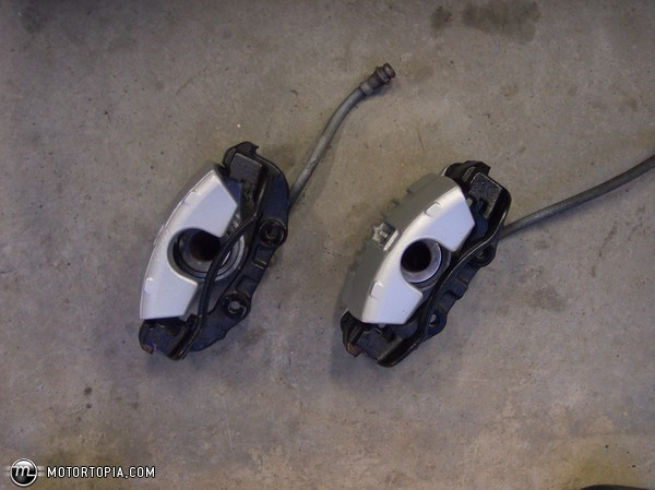

      I am not posative but I thought I read that the c6 rear calipers can be used with a left and a right because the crossover tube fittings are the same on both sides. where the c5 has different threads so they cant be changed from side to side. dont know if I am explaining this very well.

      You can convert the C6 Z06 6-piston front and 4-piston rear calipers by swapping the cross-over tube and the bleeder screws, but all of the 2-piston and 1-piston C5/C6 calipers are machined to be either left or right hand only and cannot be converted.
      Best solution is to inboard your shocks and then run either the LS1 or C5/C6 setups with LH/RH calipers. If you're thinking about mini-tubbing your car for larger rear tires, you'll probably want to consider inboarding your shocks anyway.

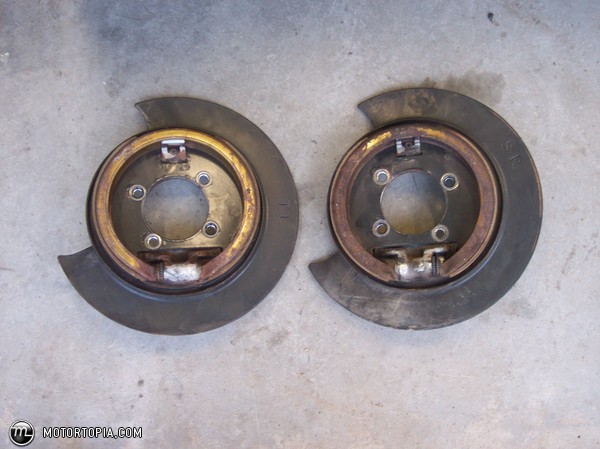

      Relocate the backing plates..... found this info.
      http://rides.webshots.com/album/106437089WdibtM
      Olav
      Aug 2005
      Hamilton, NJ
      4,318
      Quote Originally Posted by Olav
      Olav
      Not sure if it matters, but those are LT1 rear brakes
      Scott from NJ.
      Vent Windows Forever! ...
      Oct 2006
      Norway
      513
      Quote Originally Posted by BonzoHansen
      I know but it should be possible with the LS1 brakes also...

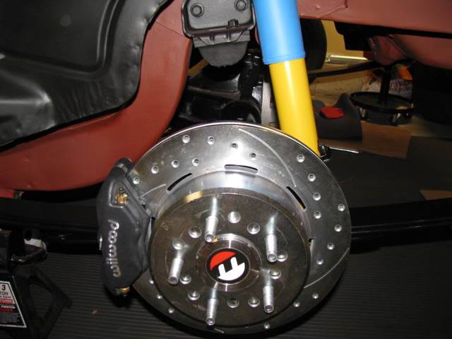

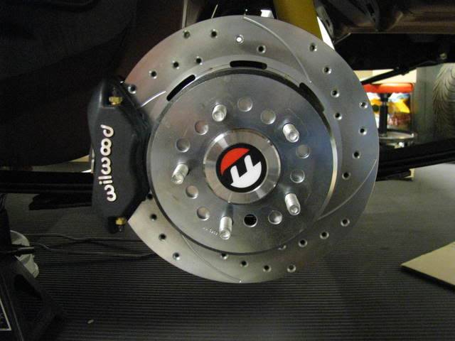

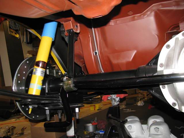

      This is not true at all Allen.............Wilwood, has a setup specifically designed for the staggered shock setup on my '73 Camaro, with parking brake hats as well. You do not have to move the shocks inboard to cure this problem. Call Frank @ Prodigy, he can set you up with the right stuff. Just make sure that you specifiy it is for a staggered shock setup, that is very important.
      I can post pics, if need be
      Scott

      Scott, post 'em up

      Nice stuff. Did you get the complete setup (F,R, booster, lines, etc)??? What did they run you, ~ $2K?
