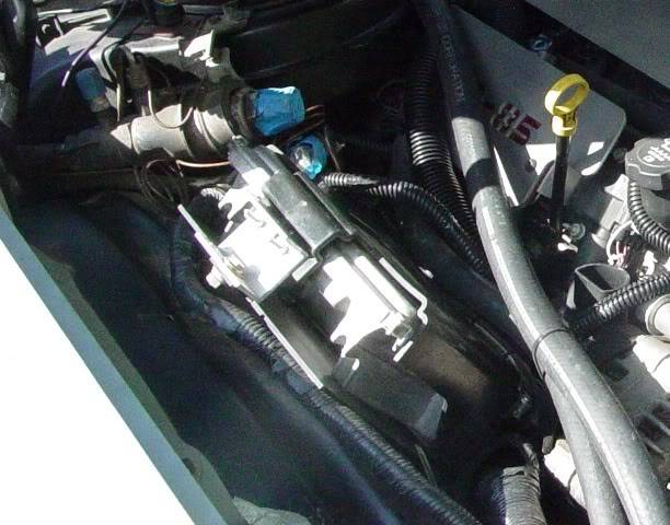

      I am going to mount my 2002 F-body computer on my inner fender well and was wondering how to actually mount it??
      What have you guys done??

      I used the factory f-body mounting bracket and made an aluminum plate that would allow the factory bracket to mount to it and then the plate was bolted to the inner fender. The channel and little screws seen in the photo are only there because the factory bracket mounting foot broke off when I was test driving the car with no front end on it and had the pcm hanging by a rope using the bracket. To much load for the bracket I guess so I had to put the band aid on it. I have seen many folks just change out the 4 cover screws with longer threaded screws that will allow the pcm to be bolted down using the longer screws. It would be flip over from the way mine is mounted using the factory bracket.
