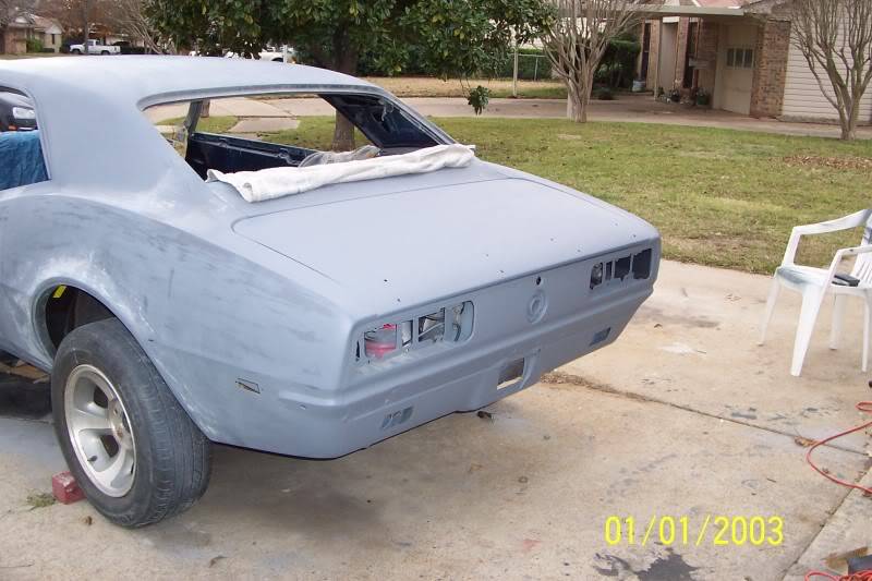

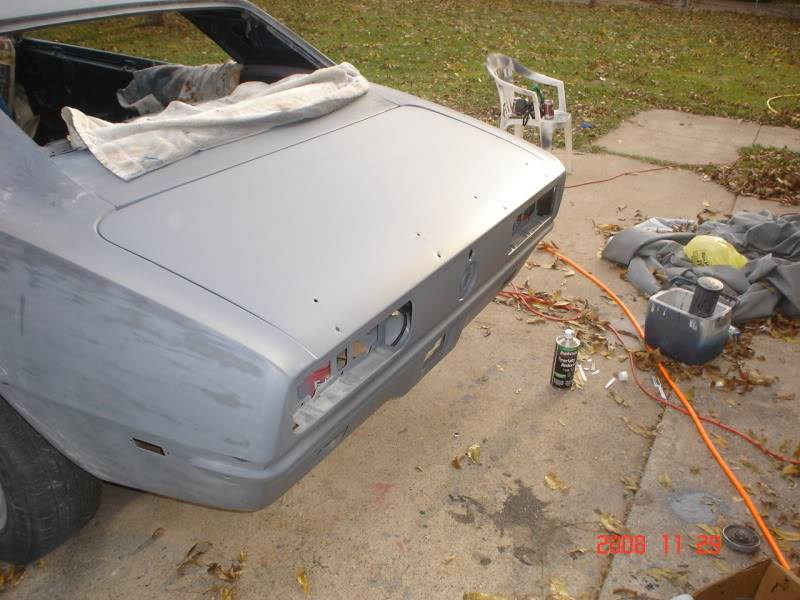

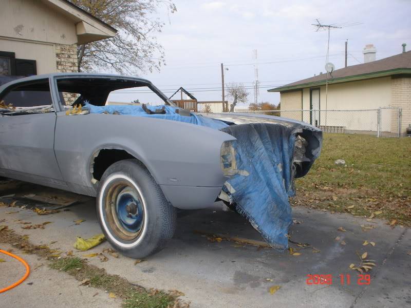

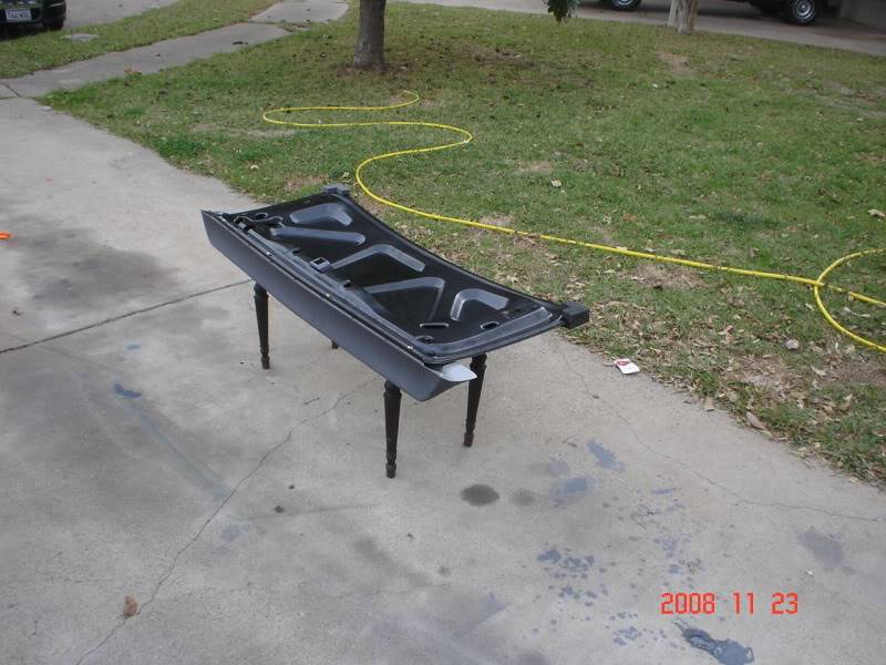

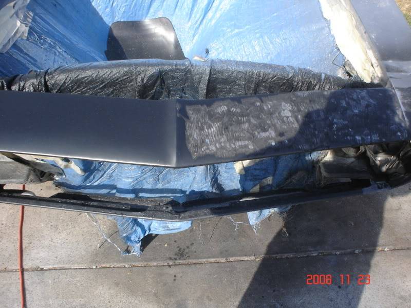

      11/23/08*

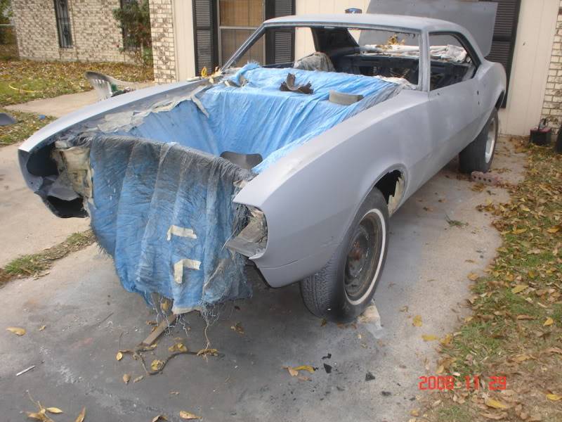

      Angel Update.
      Well not much done but its been a long exhausting weekend.
      Managed to get the deck lid lined up finally, and was able to scuff it down.
      Was not ready to shoot any primer this weekend as its been cloudy, overcast and cool.
      Once I got the trunk lined up, I pulled it back off, removed the spoiler, reset the lid and
      scuffed. All I got to do now is git it in primer. Moved up to the front section of the car
      today and got 90% of the screw up (dont ask) taken off down to bare metal again.
      I got a little more cleanin to do on the fender sides. Once I get all that ol paint off
      I am going to pull the valance panel and header panel again to clean those two parts up.
      Hopefully if I don't get any time in out it during the week, Ill be able to spend a few
      hours on it thurs after I stuff my gut with turkey of course! Gobble Gobble!

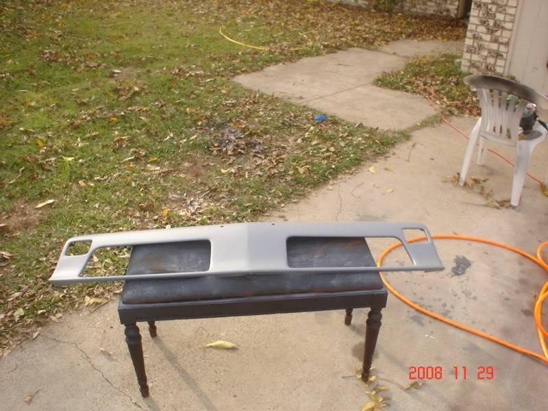

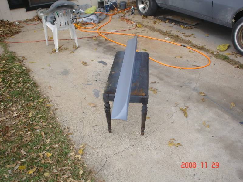

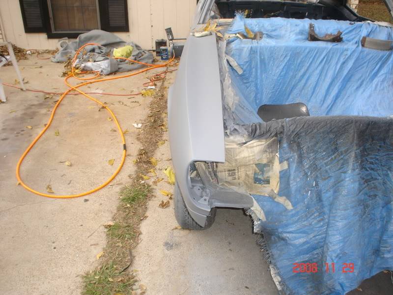

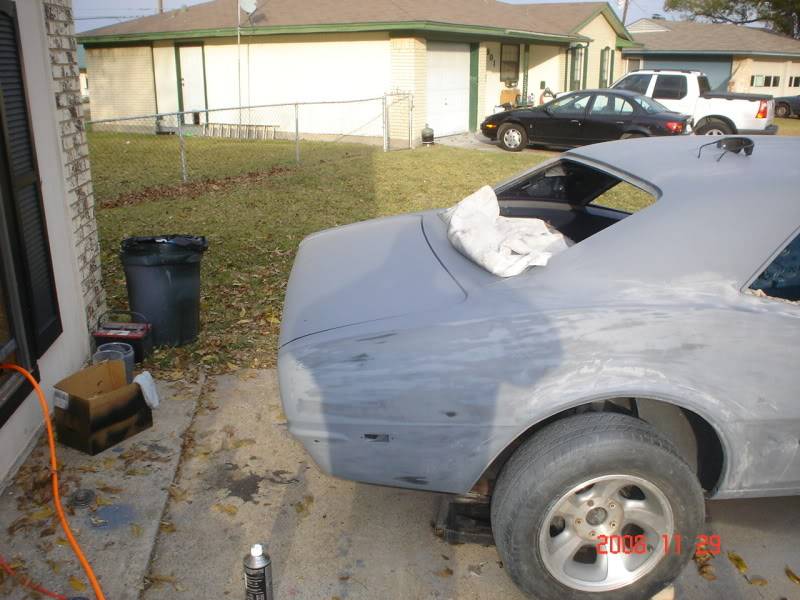

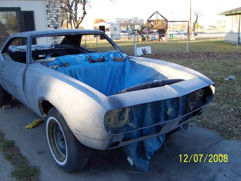

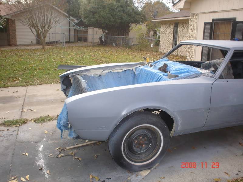

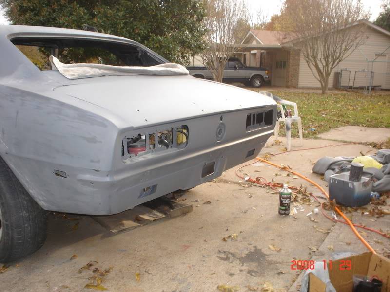

      11/29/08 Angel Update
      11/29/08*
      Angel Update:
      Well the Texas weather started off warm around 12pm. Id guess it was around 70 degrees when
      I started to primer the body panels. By the time I got done the temperature had dropped to
      56 degrees. Thats how it is in Texas. If you don't like the weather, wait a minute and it
      will change.

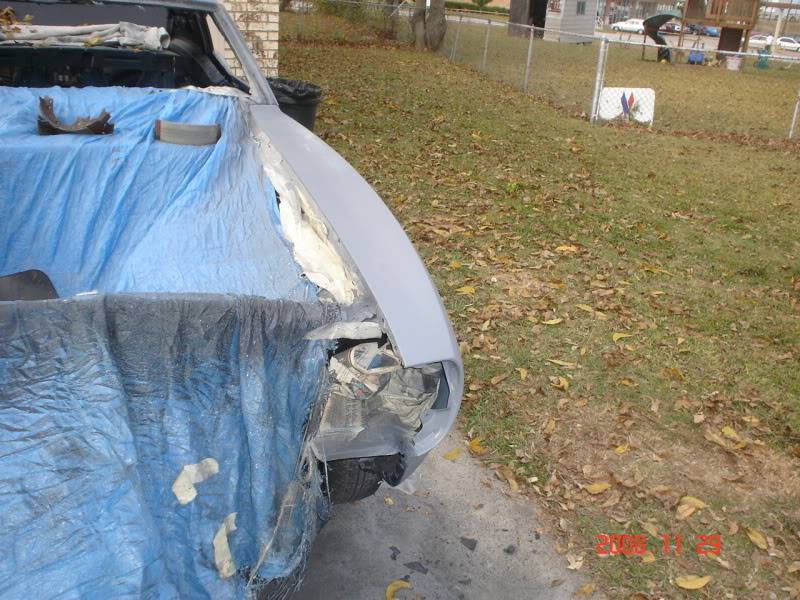

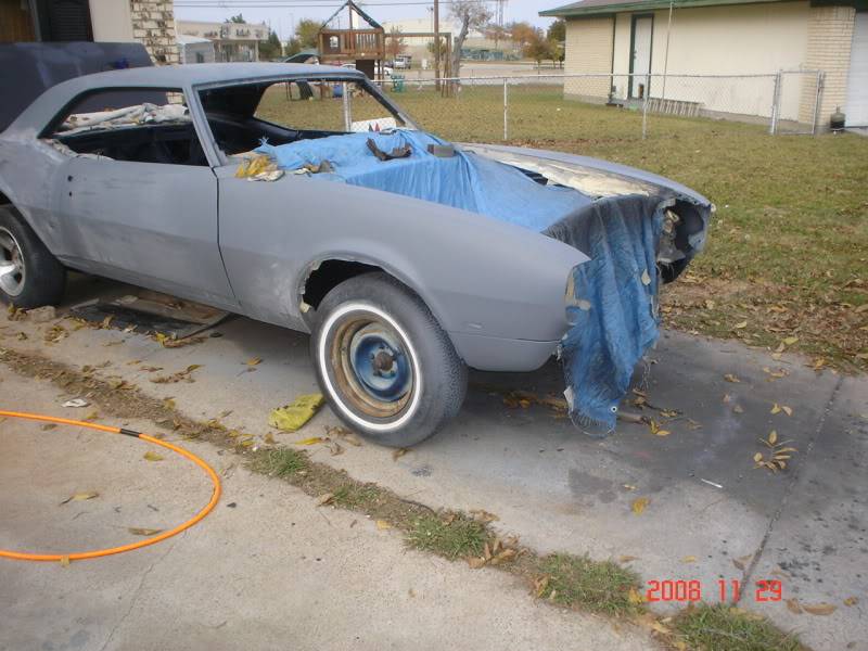

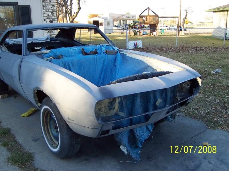

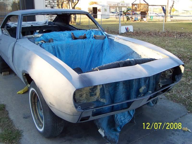

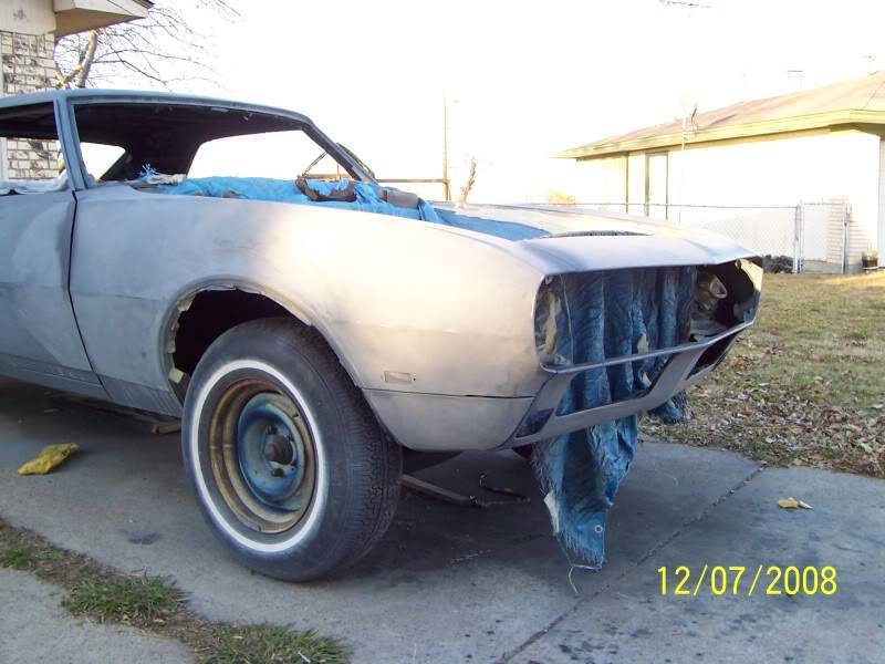

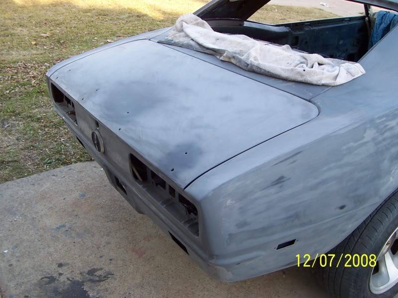

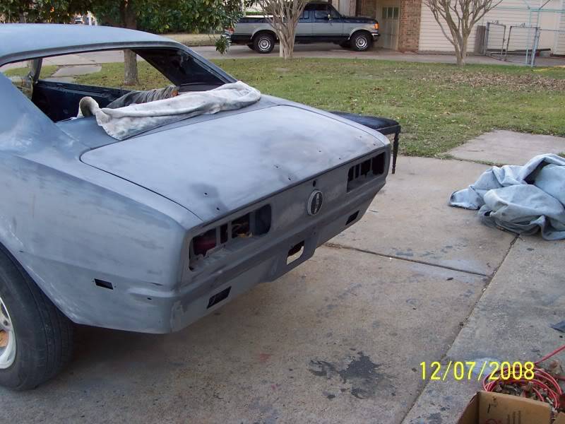

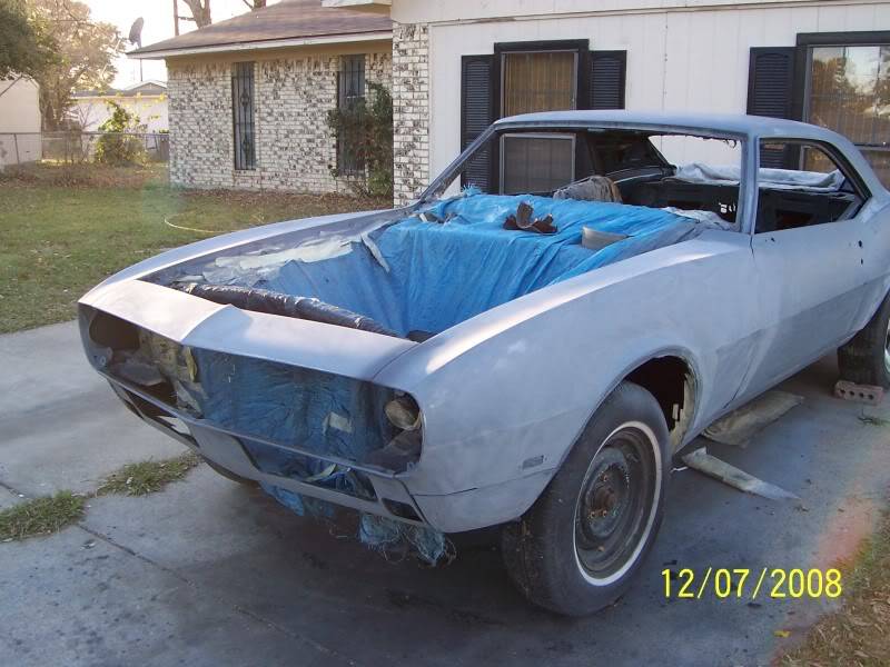

      12/7/08*
      Angel Update:
      Got the front fenders blocked again. Next week I will try and reprimer the front fenders,
      valance and header and rear tail and trunk lid. On sunday I should be able to take 400 grit
      to the fenders, header, valance, roof qtrs, and tail panel. Need to work a little more
      getting the alignment on the valance panel if ill be dammed if after all the bolt holes on
      the driver side do not line up perfectly. They are off about an 1/8 to 1/4 inch. Needless to
      say, I dont have anyway of moving the holes around one way or another, so it will have to
      do. I still need to put in new front end hardware, bolts and bushings. I am leaving the
      whole front end installed loosely that way when I go to break all the parts back down after
      paint I wont have to worry too much about breaking the paint seal on the gaps, it will
      alreay be loose and will give me an area in between the gaps to get a good paint coverage.
      The trunk lid as a small shallow spot about the size of the end of your thumb I will need to
      fill. Block all the rocker areas with 400. I am about 98% there. I could paint it now
      probably other than the shallow spot on the trunk lid. Ill probably spend at least one more
      week after next weekend, trying to go over everything and look for sore spots, or spots that
      need more attention. Other than that, she is ready to be blue as far as im concerned.

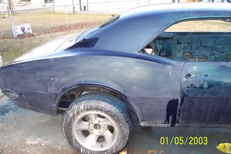

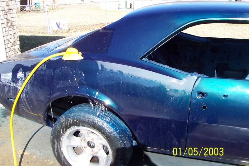

      Latest Update
      I got started on the cutting.
      Started out on 1000 grit using both my durablock and this new kind of hook and loop block
      and pep boys. Using the durablock to get the heavier stuff off, and the new block to get the
      lighter easier peel. Going along pretty good being the rear qtrs are the roughest parts on
      the whole car. The doors and roof will go a lot quicker. The passenger qtr took me pretty
      much the remainder of the day as the peel was pretty bad, and the sections of run.
      I got all the run out without having to use the razor blade.
      Can't wait to make it all the way around the car, and use the 1500 and 2500.
      Ill post as I can.

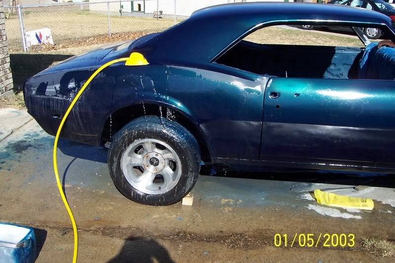

    19. #39
      Jackson Ms
      1,220

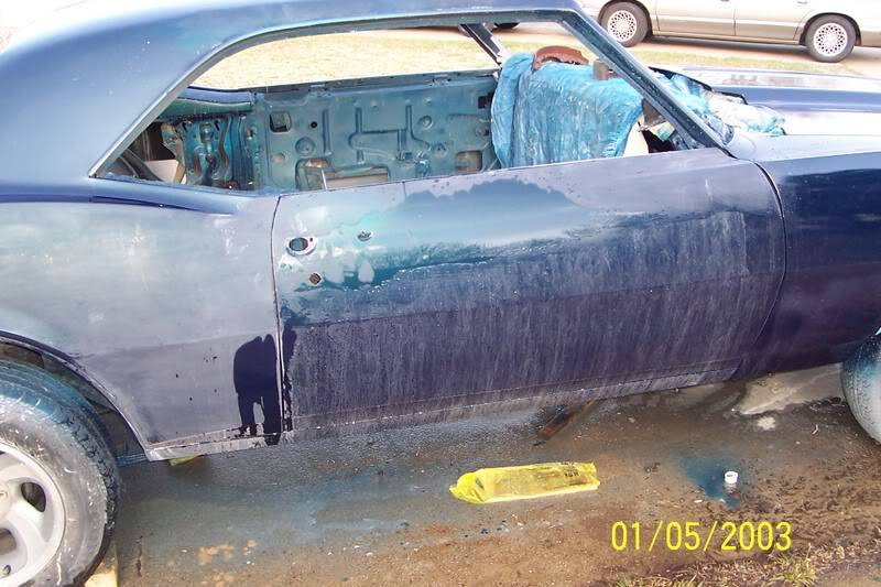

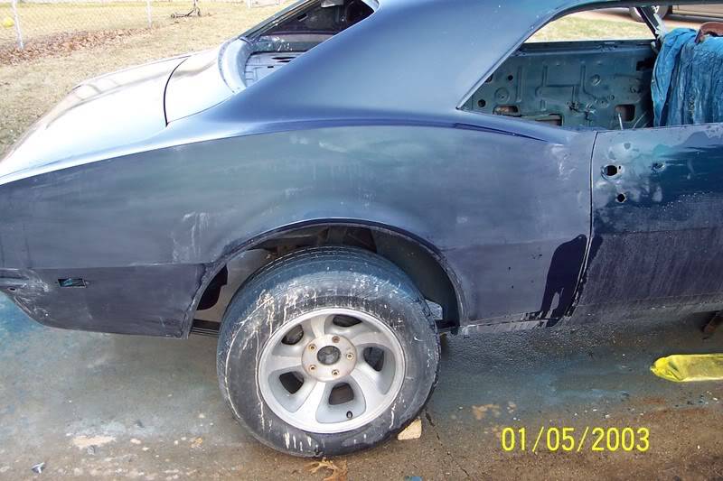

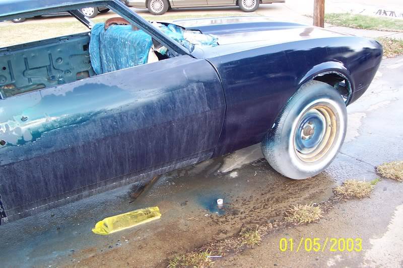

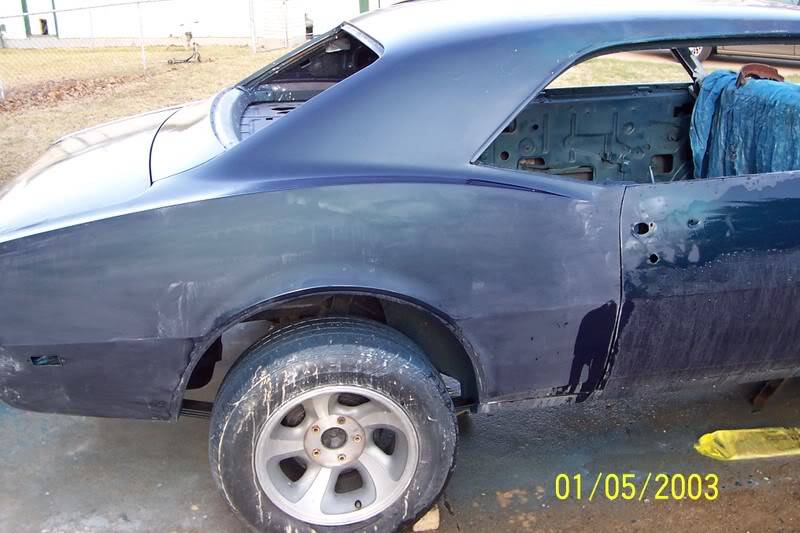

      is that base coat clear coat? if so and you sand into the color then you have gone to far.
      i noticed the blue water under the car.
      if time is a concern jsut put the car back together. it can be cut any time down the road.
      Chris V
      SOLD
    20. #40
      May 2008
      Mesquite Texas
      319
      Quote Originally Posted by SatisTraction View Post
      Its a reflection of other material
      Its a long story, but the clear coat is fine.
