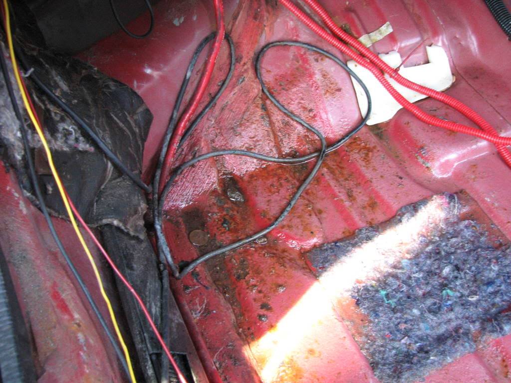

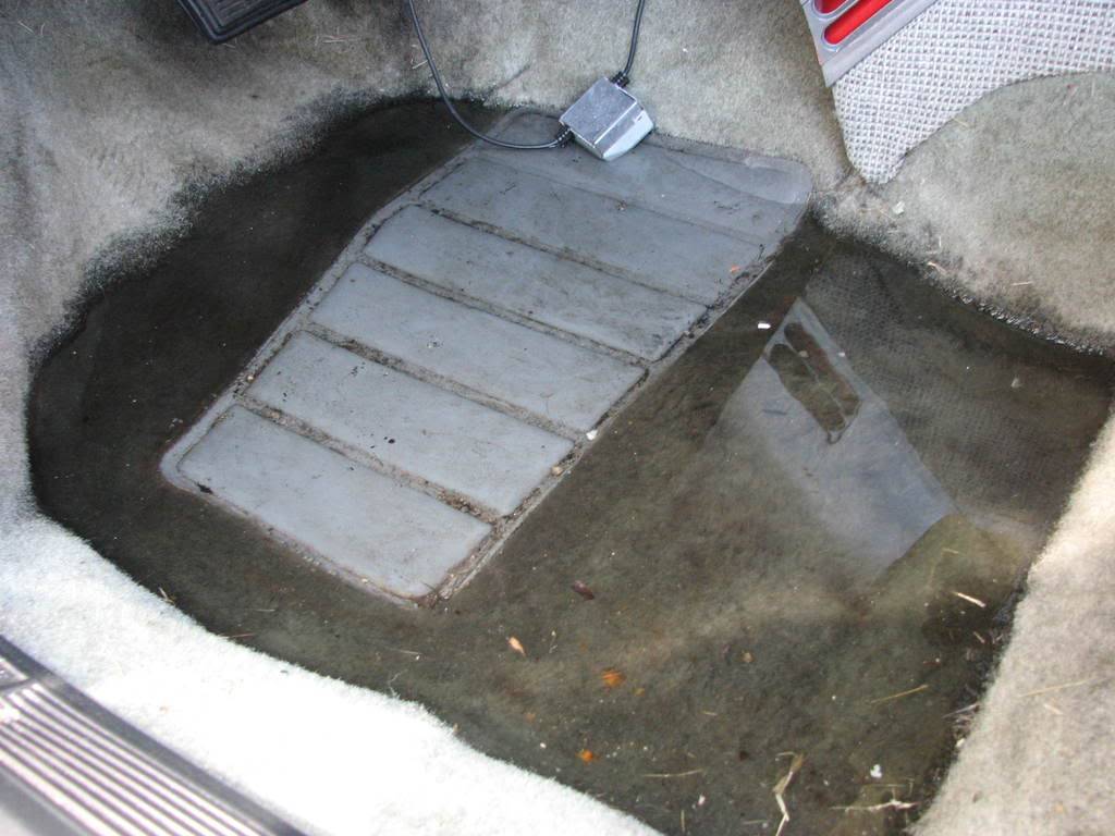

      yeah for the z24 mainly concerned for rust since I had a water leak on my firewall and had gotten big puddles
      some slight rust

      Quote Originally Posted by zman1969
      with that much leaking in should be easy to spot where its coming from
      I fixed most of it actually and that was over a period of time I dont drive the car that much (transmission needs replaced)
