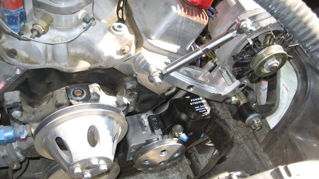

      My car is still on jackstands so I can't give you a durability review, but Unisteer and Detroit Speed both offer the GM type II pumps. Definitely a step up in price from a stock replacement. Here's a pic of my Unisteer unit:
      I'm running a double-groove pulley now though
