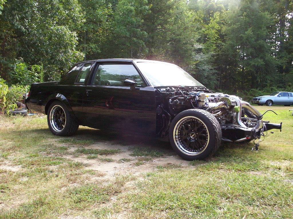

      working on a GN for a customer...up and running and first "test run " without the correct tune was 330 rwhp at less than 1/2 throttle! without the alky!! should be hoot to drive!

      man thats got some nice goodies on it..those things still turn heads around my area..at least i look at them..

      the guy that has helped us out in our hour of need , cause these things are to say the least are "qwerky", has 75 gn's in various states of condition and 4 gnx's... Not to mention every part off of these cars 20 fold. I guess we'll be painting a few of those 75 as payback!

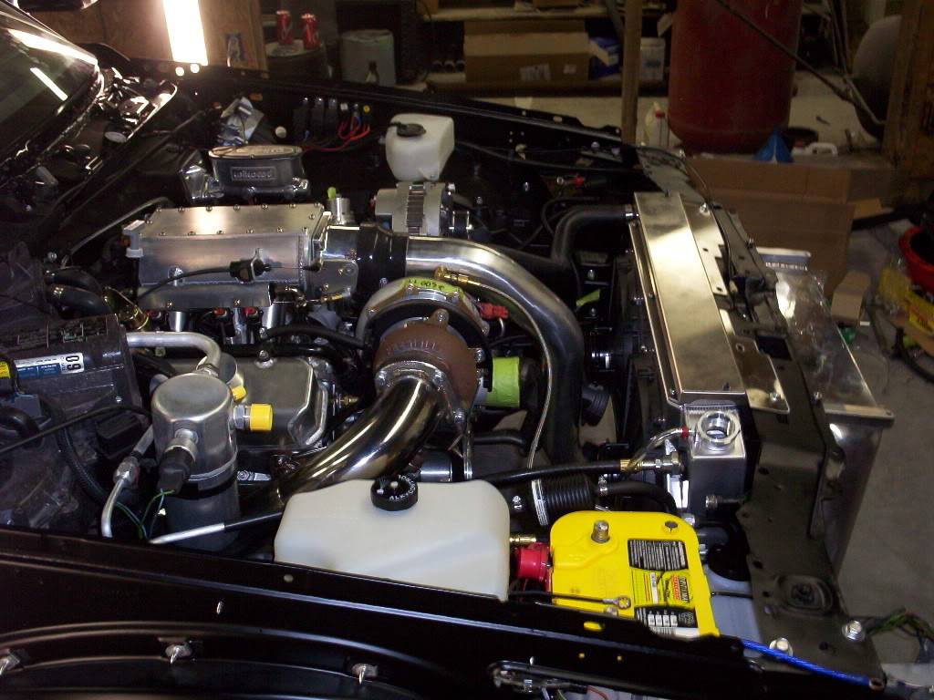

      What radiator is in that?

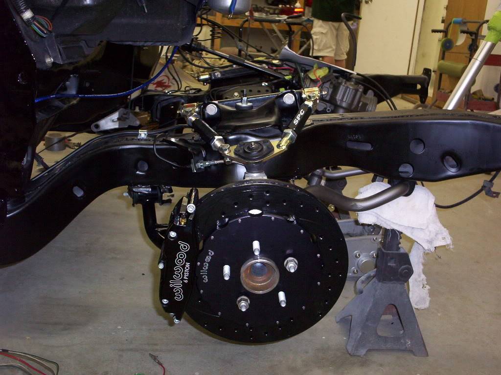

      Hot damn, that is sick!! What spindles are on there?

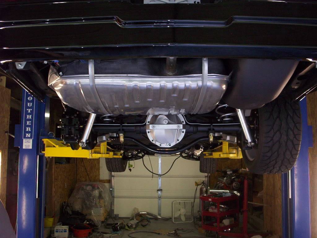

      NICE.. im a sucker for a well built G-body (as would be expected) .. is that a helwig or spohn rear sway bay??
      how do thost QA1´s work for you, have heard mixed things about them.. (i can only recomend a hydraboost by the way... )

      hr partsnstuff bar...good for straight line stuff not so good for cornering
      qa1 ok on rear but dont buy the front kit, would rather have the varishock setup , has monoball top and captures the spring to make it a "true" coilover.
      with the m/c on that adapter, the ratio is changed that you dont need assist(so we've been told )..had to drill new hole in brake pedal arm.

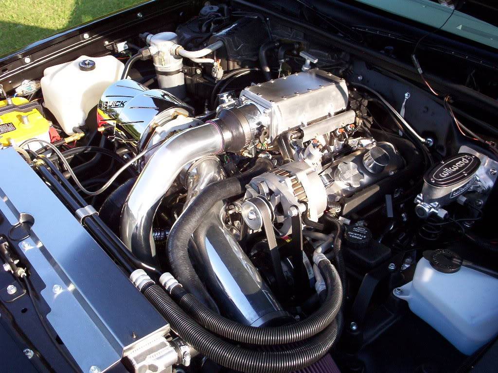

      doing final tune sun and going to tape the dyno run ...so i'll put it up asap.

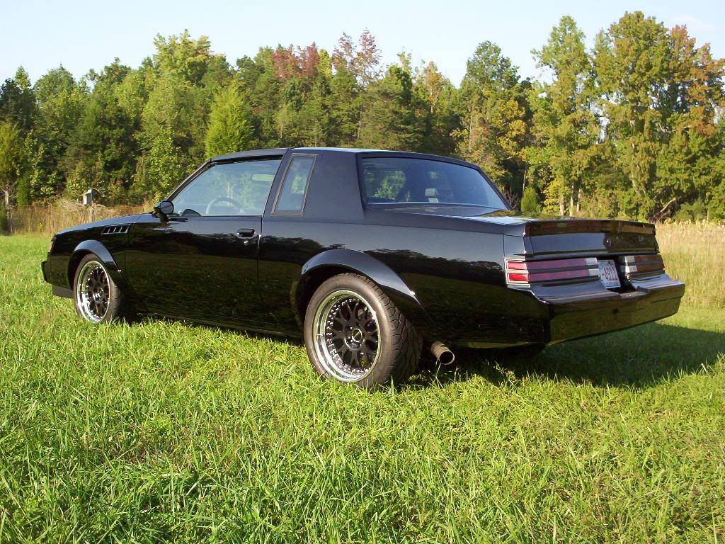

      What are the specs on the wheels/tires?

      car finished for now...may need a little tlc after owner thrashes it for a little while
      ended up with 523 rwhp....it's scary

      VERY nicely done. Love the GNx touches.
      I see too many GN's with horrible wheel choices.
