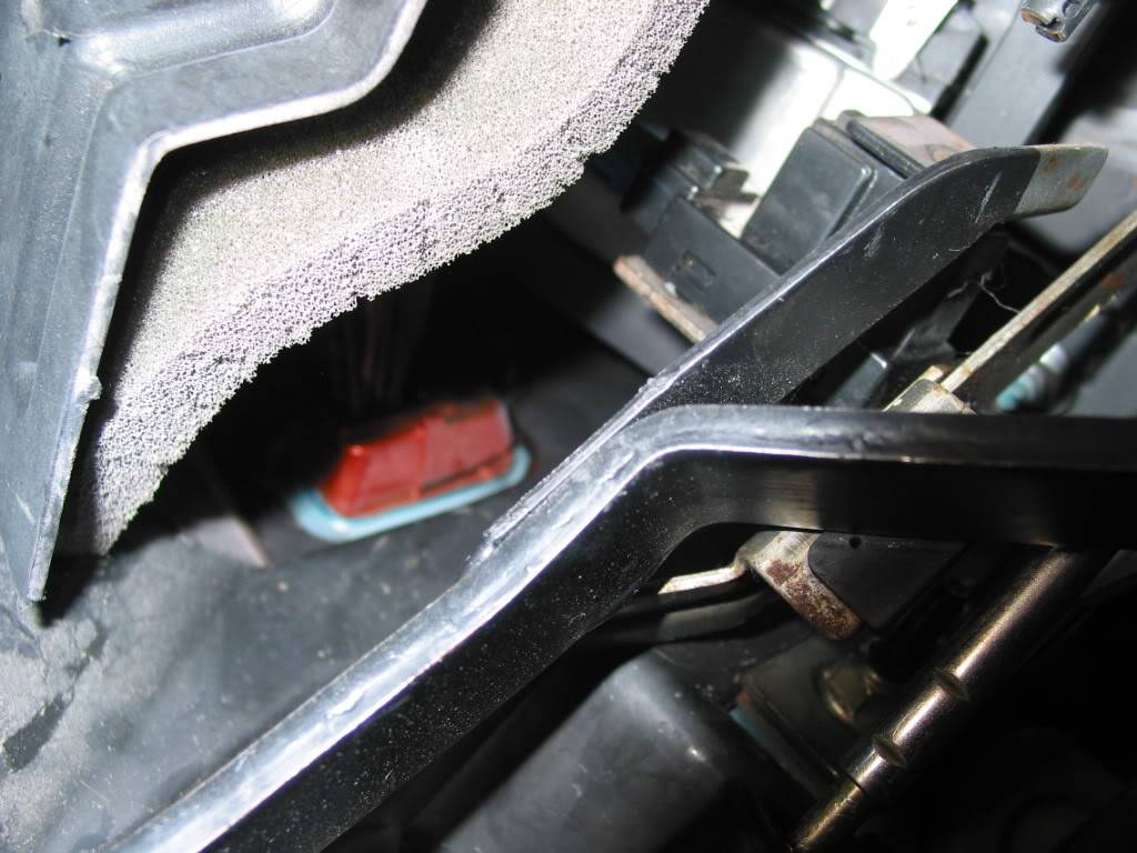

      Fourth gen cars use a Clutch pedal safety switch that is actuated ( depressed ) when the upper portion of the clutch pedal arm contacts it. ( the clutch has to be fully depressed ) This completes the circuit for the starter relays coil. The contact side of the starter relay then completes the ignition switch to starter coil circuit.

      Here is the switch dead center in the pic, the clutch arm is at the top of the image.
      Here is the switch depressed with the clutch pedal depressed. There is a bracket on the pedal arm that depresses it. Both views are with the camera pointing straight up from the floor.

      Thanks for the pics, it's a little hard to see it but I finally caught it and it looks like it won't be that expensive. Now it's time to call for the part number and the price.
