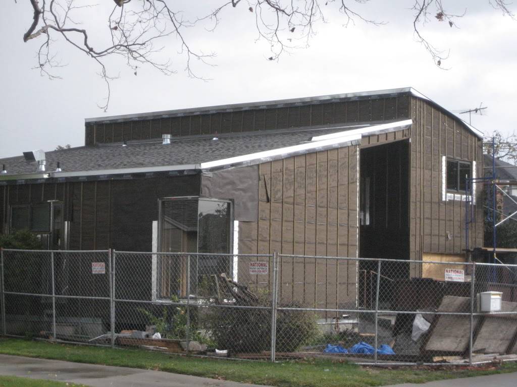

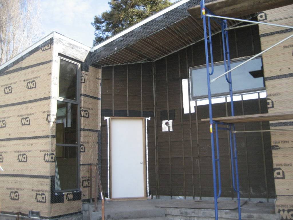

      We started with two layers of building paper everywhere...
      Then added the 1/2" strips of ply at each stud.... In this picture we had just installed the corner window so the strips are missing around the window...
      Then we installed the wire lathe where the stucco goes, it is attached only to the fir strips... We're getting Cedar siding in the area around the porch...
      The stucco does get pushed into the cavities a bit, but we were assured it would not contact the building paper behind. The rain screen is vented at the bottom with the metal with holes, with vents under the porch ceiling and with vents in the upper part of the second story walls .... I don't have a picture right now...

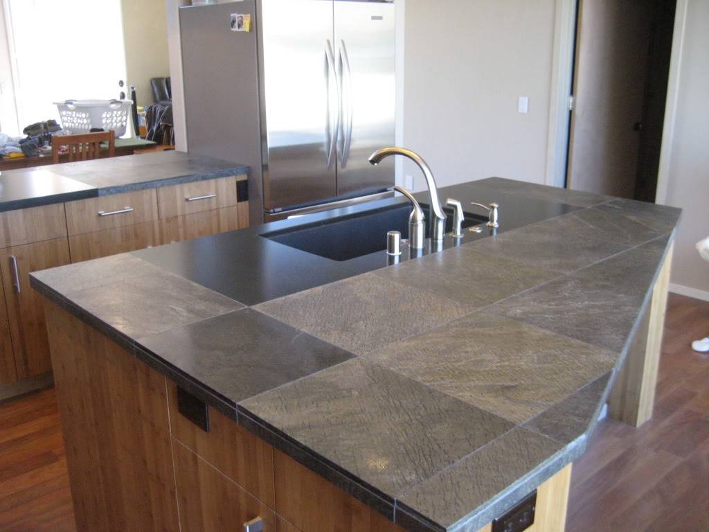

      We were finally able to move in a few weeks ago. It's been a long journey. We still have tons of unpacking and organizing left, I still have a bunch of painting to do and a deck to finish but it's good to be home.
      Here's a couple of shots of the front and my favorite part, the kitchen.

      very nice Steve, I love the corner glass window. Very modern.
      wait....no 2 car garage?
      Congradulations on the move in.

      sweet house..what type wood on cabinets..looks like bamboo?..im in process of buying a lot to build..looking for ideas..
