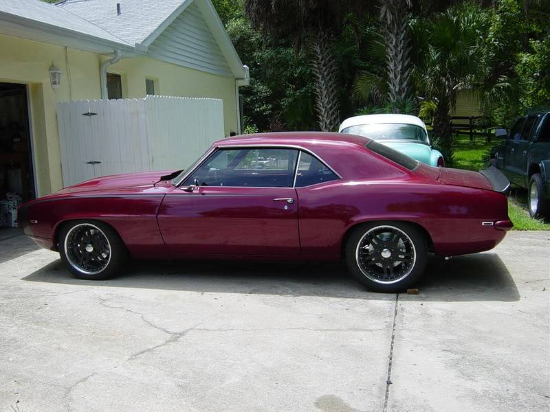

      Should look like this. Tire is under 26" tall:

      here's mine with 3" drop DSE's. with a 275/40-18...

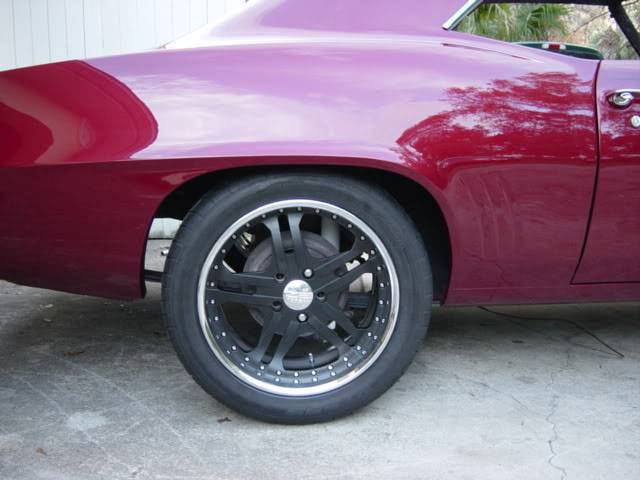

      it should settle more. here's a pic of mine before everything was put back in, tank, seats, roll bar, battery, bumper, etc...
