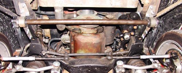

      The bar that we are currently sending or for the 67-69 Camaro does not include PosiLinks. They didn't fit very well, so we completely redesigned the bar. The new bar w/ PosiLink should be on the shelf within the next few weeks. I don't have any images yet, I'll post them asap.

      The new Camaro MusclebBar is a similar design to the new 58-64 Implala bar that we just finished. Here are some pics of it.

      Damn ! Thats a good looking bar ? Are those splined ends ?
      Do the links work with stock a-arms ?
      Do they work with a lowered car ?
      Will my 8 " balancer clear ?
      If the newer / re-designed bar is gonna' be available in a few months , I'll wait and get one.
      Thanks again !

      The Impala sway bar is 1 1/4" and I am pretty sure the the Camaro will be the same. We looked at using a splined bar, but it was too easy to get them clocked wrong, so we went with this bolt on design.
      Keep in mind that these pics are of the 58-64 Impala MuscleBar.

      I think so, but you will most like have to weld a tab to the front of your control arm. Haven't tried it yet tho......
      $395 for everything you see in the pic.

      We have not tried it on the factory arms yet, we have only fit it on our StrongArms.
      The main reason for using the PosiLinks versus a traditional endlink is performance. When entering a corner with the a bushing type endlink the first inch or so of compression you are merely compressing the bushing, not twisting the bar. With PosiLinks you are always on the bar. Second reason is durablitly. We have been using these for a couple years now and I have yet to see one wear out. They can take up to 45 degrees of misalignment.
      The main reason for using a bolt together type sway bar versus a bent bar is tire clearance. Also on the Impala's, steering box clearance has always been an issue. With this bar you can use any steering box.
      Oh....and they look cool too.
