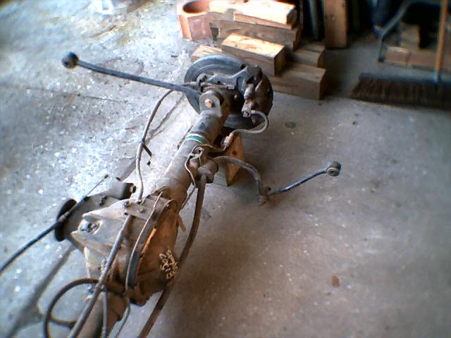

      I haven't posted for a couple days but I have been busy. Got the bed off and cleaned the frame prior to painting. I test fitted the tank using wooden crossmembers (being a carpenter, I find wood easy to work with, got all the tools I need). Made all my fitment mistakes with that, then bought some 2" wall heavy sq. tubing and have fabbed my crossmembers and brackets for the tank. Just got stuff bolted together now and probably won't weld any crossmembers until I've driven the truck a bit, which will be a while yet.
      Took some pics with my crappy camera.
      This is the rear end I'm going to use and I've been looking at the control links, wondering if I should try to make them work. It has what Ford calls anti-wrap members in the front and a small gauge way bar in the rear, with an additional pair of short bars attached to it. There is also a bracket attached to the pinion bart of the rearend that looks like some sort of panhard bar was fitted also.
      As I said earlier, the Explorer frame must be about 40" wide because that is about the spacing of the anchor ends of these bars. But the rear ones look like I'd be able to re-arrange and make fit under the Rangers narrower frame. The front ones I'd have to remove the welded brackets on the rear end and move them inboard. There is room to do that, though.

      About those suspension bars that are pointing forward on the new rearend. Ford calls them anti-wrap bars and I assume that they perform the function of preventing pinion rise during acceleration. They are pretty short, though, only 19" eye to eye.
      I understand that one of the problems with arms like this, and ladderbars, is that the bars and the leaf springs move in seperate arcs and bind because of that. As to why Ford would put arms this short on the Explorer is a mystery to me if that's the case.
      How about if I made some new arms that were longer. I could make them the exact length of the leaf front half distance (25 5/8") and could set their front mount positon to be exactly the same as the leaf springs. That would give both the leaves and the bars a common origin centerline and eliminate the seperate arc business. A single stout bar on each side along with an axle over spring setup should control any wheel hop, I would think. This is a street truck and if I can get by without a bunch of ladder bar or 4-link stuff hanging down below the axles and springs, the better, I guess.

      Quote Originally Posted by Robprime
      If those links run parallel to the leaf, then there won't be any bind. I think it's called a Link/Leaf system. The rubber bushings in the links can handle some convergence towards the front. If you made them pivot off the front leaf bolt as you suggest, you would be making a huge anti-roll bar out of your rear axle housing, because you would have a triangulated link/leaf arrangement on each side.
      That's an interesting idea, Dave. Would that be good to do?
      I really hadn't been thinking about the horizontal plane when I was considering what to do with those front links. I had only thought to try to control any axle wrap and binding in the vertical plane.
