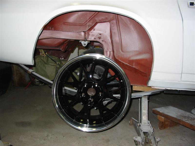

      yes that is my fat hand in the way.....only covers 1/2 of the front. tires are sumitomo. cheap....as well.

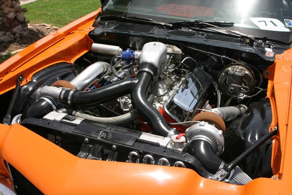

      for those wondering they are mp70 .96/ar for each bank. 60mm wastegates on each bank, and 50mm bov going through an custom 850 carb. im getting a FMVB 4l80 built to replace the 700 that is in there now. the headers are 2"id pipes into a 3" collector to the turbo. 3" downpipes and mandrel bent exhaust with full mufflers.
      its almost done. front end is on and aligned. suspension needs to be setup and aligned. needd to mount the tranny cooler, finish wiring, polish stainless trim pieces,emblems, paint stripes,wet sand and buff the car, install front spoiler. a few more days. school is almost out so i wont have students and will be able to get more done in the coming days.

      What are you going to use for center caps? I have hear that on the front the hubs are too long to use the flat BMW caps. It looks great though for sure.

      those were conservative measures for the car. the center caps are another story. by machining out the center bore of the rim you cannot use the BMW flat cap. i powdercoated the whel bearing cap black and it protrudes through. you can hardly tell, it actually looks better than you think. i will get some pics and post them up later.

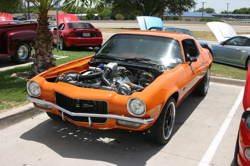

      here is a few at a local show we sponsered. the car was completed jsut enough to start and drive on the trailer. no cleaning or prep. the front is about 3 inches lower and the car is now much cleaner. i still need the stripes and other little stuff. i has a nice 1100rpm idle and the turbos spool about 2500rpms. im inm the process of a large write up with part numbers and other detailed info about the conversions, little problems and the poor mans way of pro touring. :bowtie:

      I'm not sure that a 275/315 tire setup will get that >110' braking goal though. (maybe with a softer tire?)
