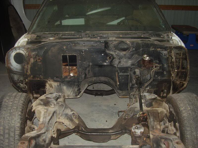

      This is what I started with
      I have had this car since 91. I got it the day after my 15th birthday. My dad and I restored it by my 16th birthday and it was my daily driver through high school.and then 2 days before high school graduation I wrecked it.
      Not shown in the picture is the frame damage on the drivers side.

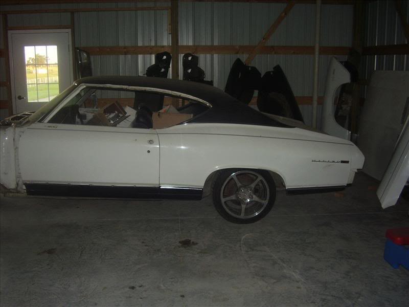

      This is how the car is now.

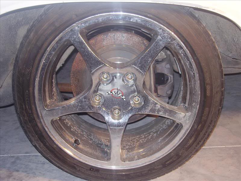

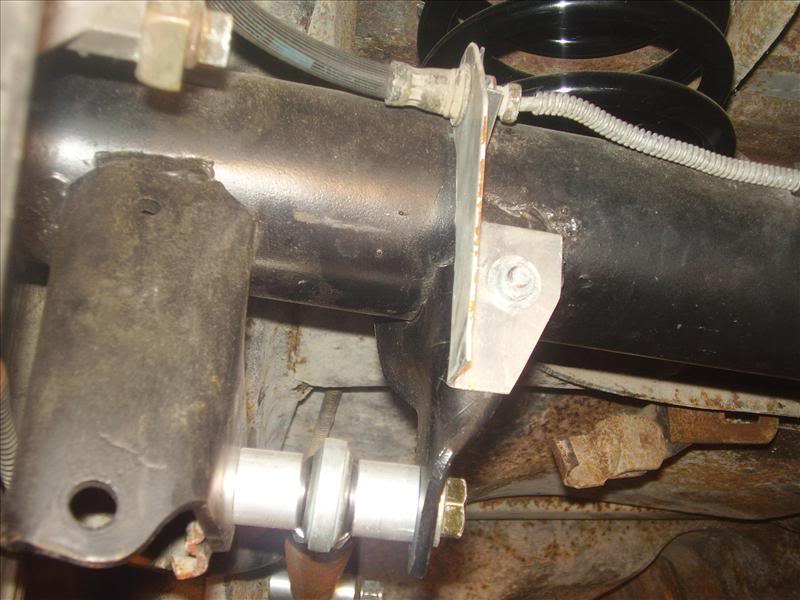

      So far I have C5 brakes and wheels on the rear

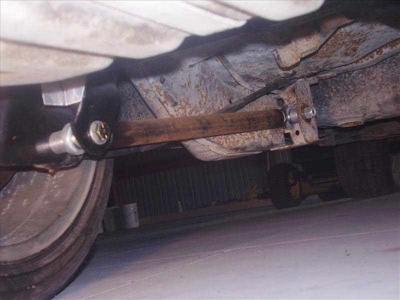

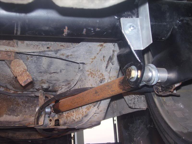

      I have edelbrock upper control arms and no name double adjustable lowers
      Custom made brake hose holders
      I have 11 inch black magic circle track springs rated at 275#
      Not yet install afco 1031 rear shocks

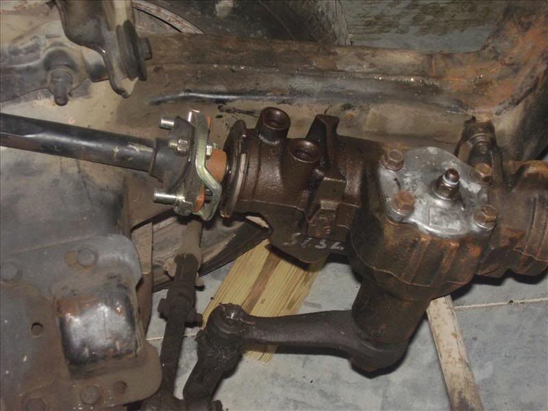

      On the front I have installed a GC steering box with a steering adapter from ebay.

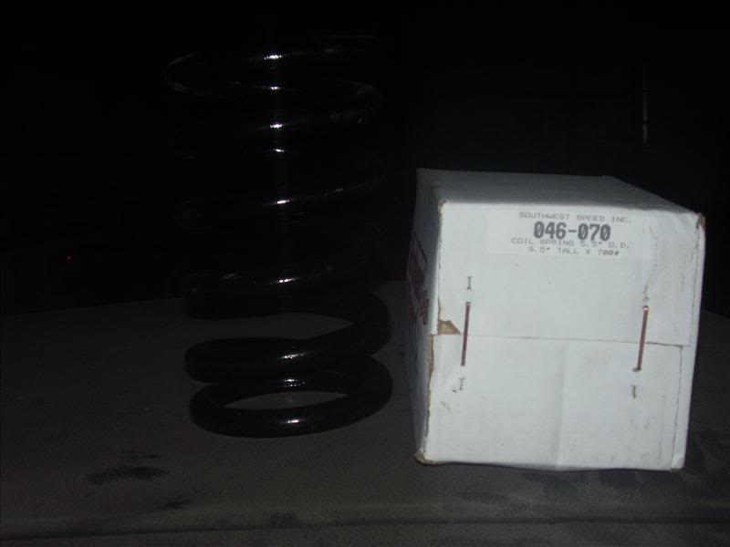

      I have 9x5.5 inch springs for the front rated at 750#
