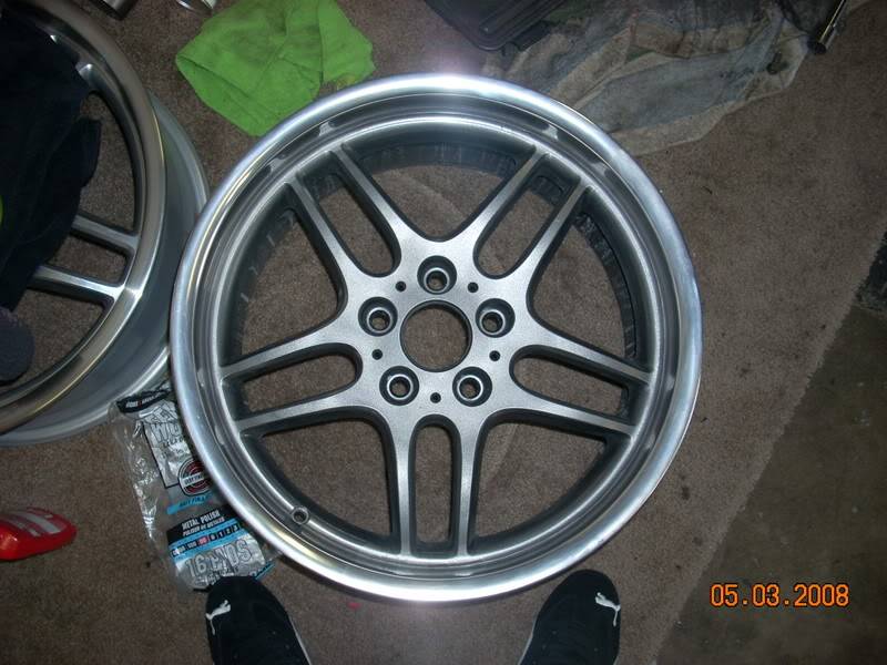

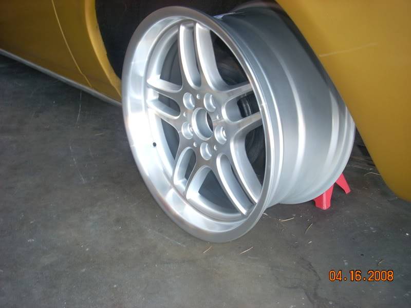

      i have them for my 70 z28!!! i got the machined ones so cause i had plans of painting them... i stripped the clear off did a ton of wet sanding to smooth out the machine marks and lots of polishing to get a true polished look... also painted the center a charcoal color.
      pics of how the came...
      and of one wheel ive done.
      but fyi they are not as advertised... the box and website said
      18x8 13mm 18x9.5 23mm
      but wheels stampings are both et20mm front and rear andrear wheels are only 9"s
      but still for the price you cant beat them and they look great.
