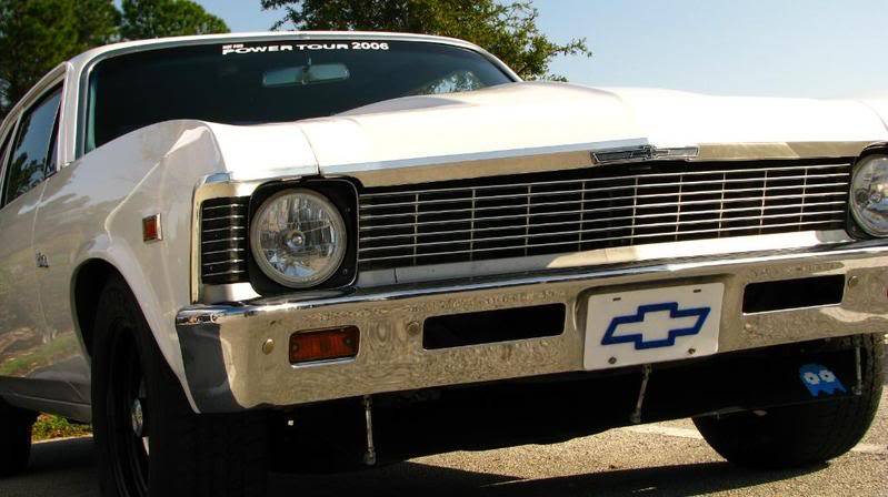

      Mine is just the metal used for a/c duct. Its bolted to the frame then the supports bolt into the bumper. I didn't see the need to mount it on a hinge, it's a hot rod not a race car so it not like I'll be fine tuning it for max performance. It's not heavy and is very stiff, oh and completly change the look of the car.

      69nova is that just treaded rod and hime joints holding it on?

      Quote Originally Posted by lt1chevelle
      These are what I used
