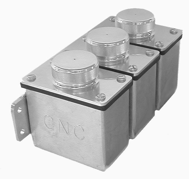

      Thus my interest in the CNC line of parts. A little more down to earth pricing along with a very good selection. I especially like their pressurized reservoir caps. Very handy in those bleed the brakes by yourself situations (which I frequently find myself in). I will order some of the CNC stuff next week to get it here.

      Chuck has always had the cool little gadgets down pat. I too very much like the pressure bleeder cap's and the simplicity in his design. His stuff just makes sense... and it sure has been tested in the most brutal environment, so you can have the confidence in its ability.
