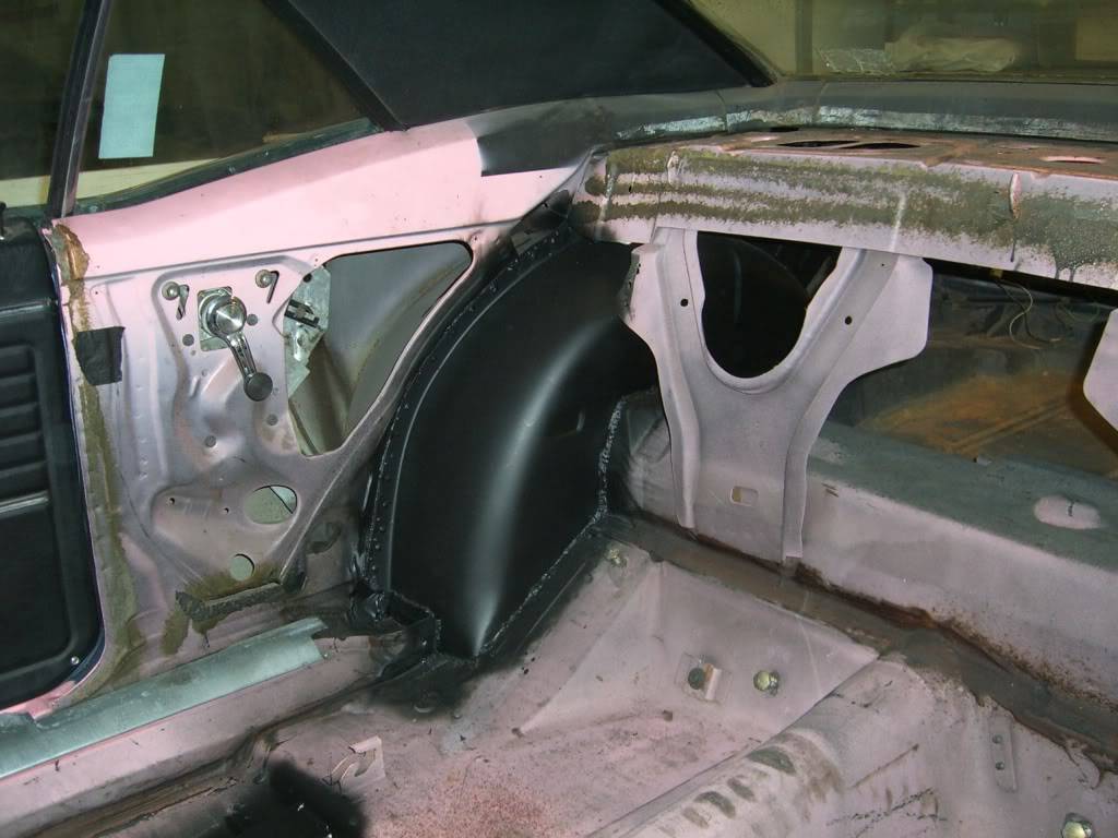

      Ahhhh the tubs are done. Thank God allmighty the tubs are done!
      Well, I still need to seam seal everything, but I think I'm going to wait until after I finish the rear suspension install and seam seal the whole shootin match at once.
      The black stuff is Eastwood "Rust Encapsulator". They said it makes a primer/sealer for underbody stuff so I went with it. I'll seam seal then cover everything in "Lizard Skin" sound/heat attenuation material.

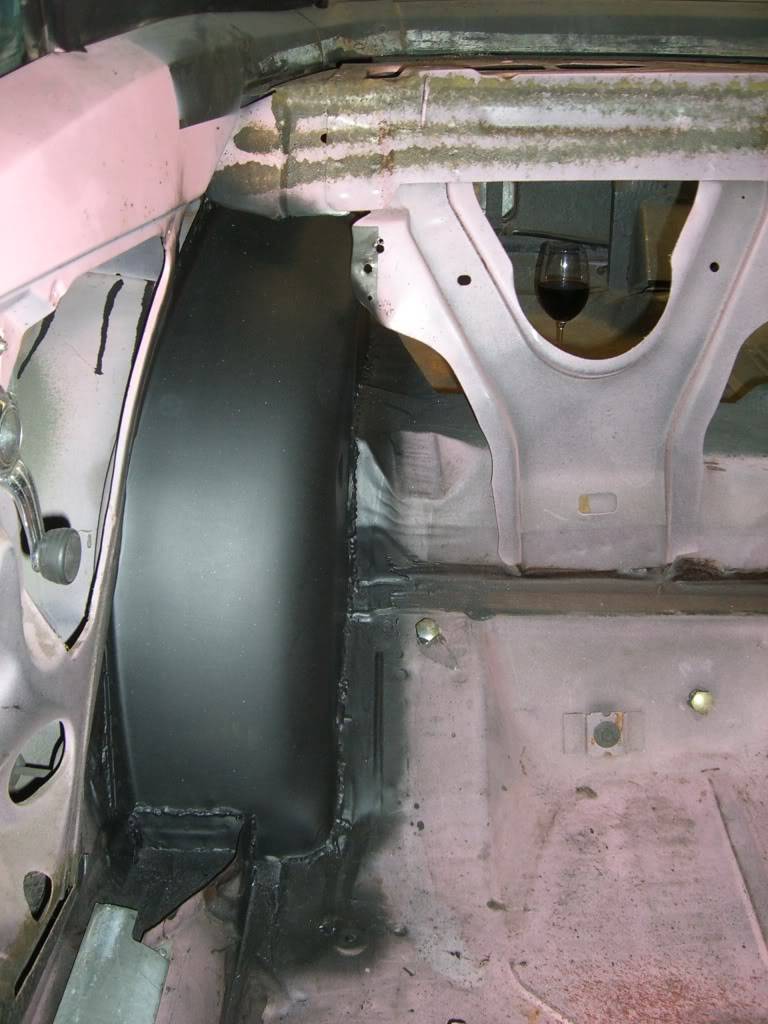

      Pax side tub from the inside:

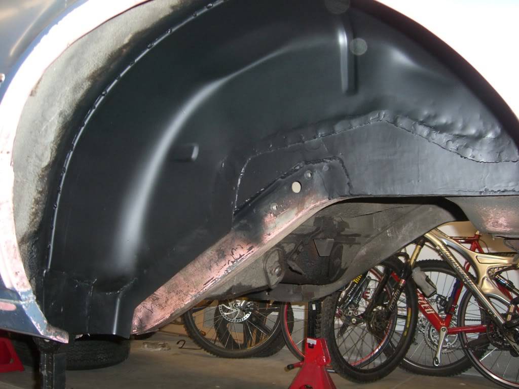

      Drivers side tub, from the outside:

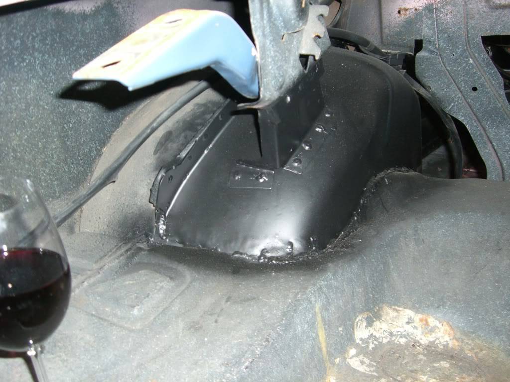

      Drivers side from inside the trunk.
      Tweaking the trunk hinge support to fit the profile of the new tub was quite a challenge. I bent, unbent and rebent each of them at least 1/2-doz times.
      The sheetmetal is a bit ugly just above the weld. I had to hammer the tub to fit the curvature of the cutout. I'll hit it with a little trunk spatter and if that doesn't hide the ripples I'll break out the hammer/dolly and smooth it.......I hope to not have to though.

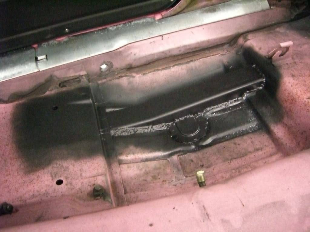

      Finished up the subframe connector as well. Welded back in the relief cut in the seat pan trimmed the body drain plug to fit, welded that in and primed the whole mess.

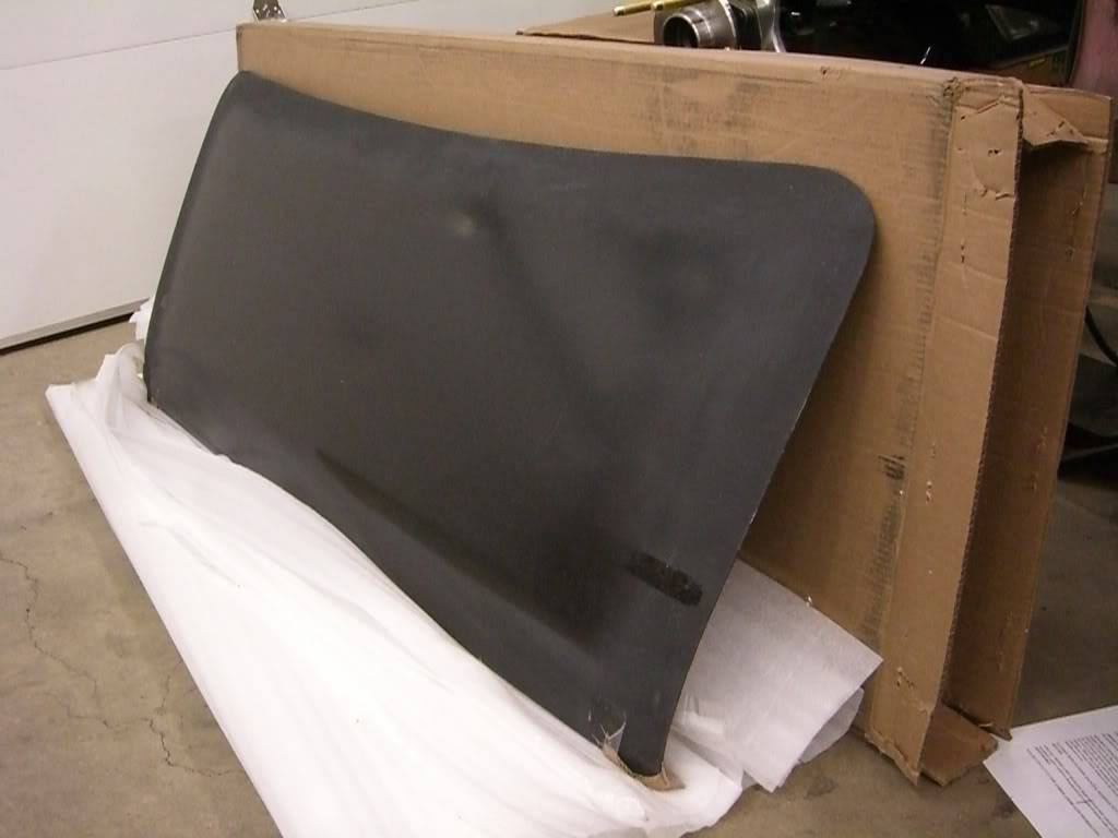

      So anyway I got a bit of lightweight goodness in the mail a few weeks back:
      Fiberglass decklid from VFN fiberglass. Weighs less than 10lbs
      Pretty darn smooth right out of the box. I'm hoping for minimal bodywork. But...it is delivered a bit oversized which is, I suppose, better than undersized.

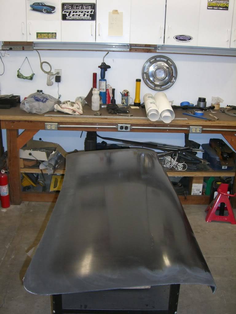

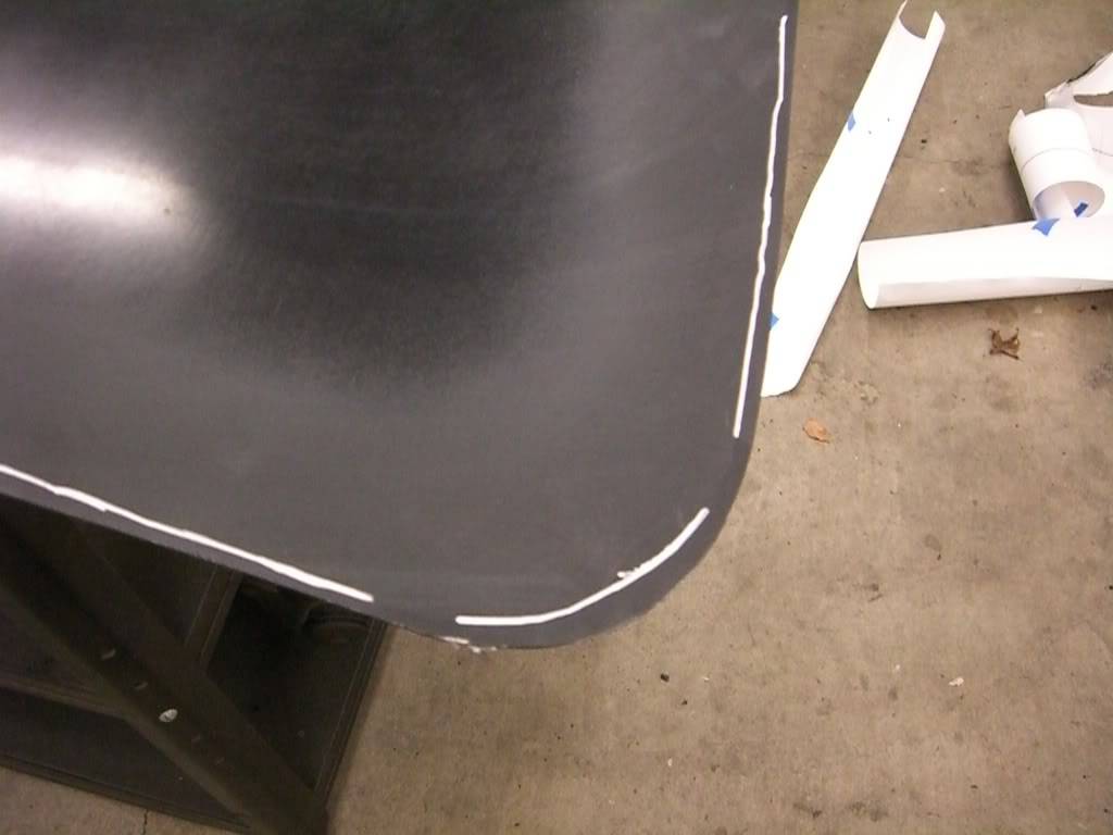

      Sooo I had to take a template from the OE decklid and transfer it to the fiberglass replacement. You can see here that the fiberglass decklid is about 1/4" larger than the template. It's oversized by about that much on each axis.
      Transferring the template. I am totally good at coloring!!!!

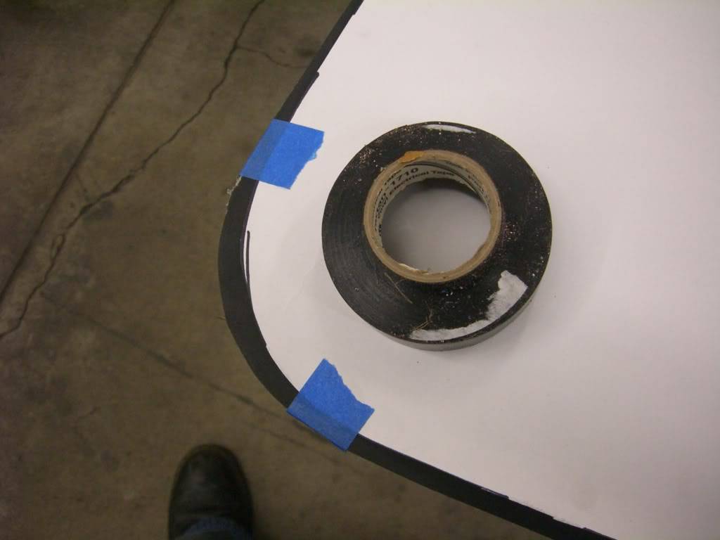

      The line is actually at least 3/16" fat all the way around. So what I'll do is cut to the line then begin test fitting and sneak up on the final dimension little by little.

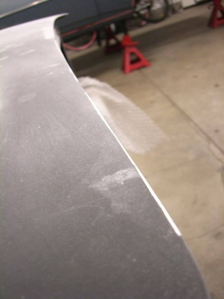

      After a bit of sanding....but quite a bit more to go.

      Having a bit of trouble fitting this decklid.
      The two forward "corners" (but they are kinda round so....?) are sitting really high relative to the top of the rear fender and filler panel adjacent to them. It's sitting about 1/4" high on both fwd corners.
      This part:
      I think the structure of the underside of decklid itself is a bit too thick and it is hitting the trunk seal/flange early.
      Solutions?
