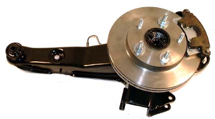

      basicly the rear disks are caddy units, on a modified plate. we had to custom make a mounting braket and used all 93 chevy camaro stuff. (since baer stuff will bolt up to that.) on project provair. it's not tested yet but when it is, we'll offer it in kit form.
      its an ongoing search.
      But. GOvair is the spot for performance or race parts. they are owned by "corvair underground" and are awsome at customer service.
      the govair struff
      Since your's is a 64 or early stile vair, its harder but govair will know what to do for you. You need to call them.
