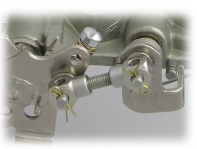

      i messed with the car today and it idled fine for half an hour in the driveway. i revved it a little, was fine. i revved it a lot, it was fine. but check this out. my throttle linkage has a little slop in it. like when you press on the accelerator you will feel it "stop" just a little bit, before you press the accelerator down further. ok when i revved it at that stopping point, the car would want to shut down. i stuck a piece of wire in there loosely to get rid of the slop, and the car seemed fine, no problems. but the wire was set in there loosely, so when i revved the engine and it came back down to idle, the slop came back and the engine bogged again.
      i've attached a pic but it's kind of a bad pic. it's hard to explain what i'm talking about if you haven't experienced it.

      The slop that you are noting looks like it is at the secondary throttle plates. Is that right? Maybe you've got a problem with your secondaries not closing properly and that's throwing off the IAC?

      Hey guys, talked to Retrotek yesterday. They said they send out the systems with the linkages because it helps setting idle for some people. They said that the reason why it's shutting off when i come off idle and hit the slop is because the secondaries are not opening at the same time the primaries are off idle. So John, you were close!
      On my Retrotekspeed efi system, both the primaries and the secondaries need to open and close at the same time. Otherwise the engine can be starved or the opposite, flooded.
      someone mentioned that a grommet would eliminate the slop. do you guys know of any other creative ways to get rid of it? i was thinking about using epoxy but that will look pretty ghetto...

      The linkage looks the same as a Holley double pumper. Can't you just bend the rod a little?

      Yes andrew, they did. Sorry I didn't mention that. They mentioned bending the rod a little, just like amx said. seemed easier to put a grommet or something in there because i don't want to end up bending the rod too far, bending it back to get it right, and having it accidentally break lol

      That still doesn't make sense to me. Most carbs or TBs have a progressive linkage where the secondaries don't open until the primaries are already open about 50%. Thus, a little slop between the two wouldn't matter.
      I thought your problem occured when the throttle closed, not when it opened? If the secondaries are hangin open after the primaries are closed on decel, that could cause a lean out.
      If on closing, you should have a spring on the secondaries that closes them independently of the primaries.

      actually john i think you are right, it happens on closing. funny you mention about the spring; i do NOT have a spring on the secondaries; they are in fact hanging open after the primaries are closed at idle.
      apparently i need a "secondary throttle return spring." the demon i had before this only had one return spring and that was for the primaries. does anyone have a pic of this (holley) secondary spring i need to get? i went to oreilly's last night and they had Universal springs so I was unsure what to get as I know springs come in different tensions...

      The secondary return spring is on the secondary shaft. You can see it in the picture that you posted.

      i'm going to get this and see if it helps:
      Summit PN Holley 20-122. can be progressive or 1:1. i think it will help

      That looks cool, but I'd try bending the linkage first. It's free and hard to mess up. I would also check to see if Retrotek set you up with progressive throttle or not. Maybe their MAF requires non-progressive because it's so close to the TB and needs uniform airflow. Nonetheless, your secondaries should not be hanging open.

      Hey guys, sorry it's been a while. Been on medical leave due to some torn muscles, so I haven't gotten to the car yet. I did get the 1:1 linkage from Summit, and talked to Retrotek. They DID say it was a 1:1 system and that bending the rod could help. I tried that but I think I bent it too far because the secondaries didn't go back down after hitting the throttle a little. Idle went way high.
      Retrotek also claims that the systems they ship out now are sent out with an adjustable throttle linkage, that is very similar to the one I got from Summit.

      ok guys, just got done installing the summit piece and ran the car for a while. while it did help some (no more "stopping point" in the gas pedal), unfortunately, my secondaries still get stuck after the rpms are 3000 or over.
      i installed a pretty strong spring to help it come back down and it didn't work. the only thing that makes the secondaries come back down to idle is if i get out of the car, and push it down with my bare hand. needless to say, i am extremely pissed. i just want my car to work and i have been screwing with this thing for too long.

      Sounds like you have a defective throttle body.

      Are the butterflies hanging up on something? Maybe the wrong base gasket or spacer?????

      good suggestion, mark. i don't think that's it though because just now i opened the throttle wide open (car is off), and the secondaries came down all the way just fine. they only get stuck when the engine is running. VOODOO
      if it was the gasket it'd get stuck whether the car was on or off right?
