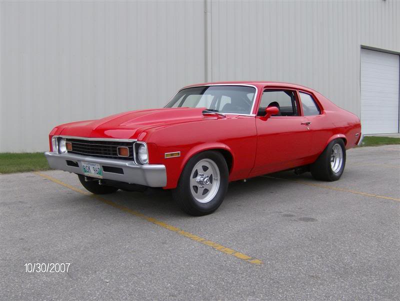

      Whats a typical front 17" wheel/backspace/tire sizing for a stock chassis 3rd gen nova? How big can you go without having issues? Also note that I have 2" drop spindles.

      17X7, 4.25 bs with drop spindles, or 17X8 with 5.0 or 5.5 bs.

      I dont know, Im taking suggestions. I want a "muscle car" looking wheel and reasonably priced....any 17" wheel ideas??

      coy c5s would look cool and muscular.
